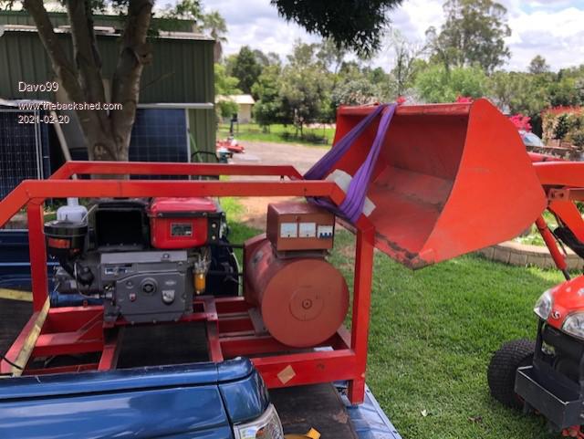

Been looking for a belt driven alternator for years, Literally and hadn't found anything suitable or affordable.  This rather substantial Piece came up so I decided to jump on it.... not that I think the seller would be getting over run with enquiries.
The seller said he had been making them in Cambodia under contract to the UN for humanitarian needs and had made a couple of hundred of them.  One of the first things he told me was he was 80 years old. ( I was thinking more 60 looking at him till he said that). He'd decided to go other ways ( Plastics Not retirement!!) and wanted to make space in his shed at home and at his farm which Ironically is just the next couple of areas back from where I am.
Luckily the guy had a block and tackle in his shed so we Hoisted it up and I just backed the ute underneath and lowered it in.  Getting it out at home with the tractor was a little more involves being the genset somewhat over it's rating  but I have learned before it will hold a lot more than it will lift and the bucket curl is more powerful than the bucket rams. I'm thinking of Up grading them.  Been looking at new tractors lately for my father. His Old 35 Hp will lift substantially more than a modern 50 HP because they are all basically derated and under capacity for OH&BS reasons.
25 x 20 Kg solar panels would be nice to be able to lift out the ute but it's half a ton and I might be pushing the poor little thing a bit there!  :0)
Looks a bit precarious but I shortened the sling and got it off without ripping anything apart.  Glad I did do it on the grass. Lifted it OK, drove the ute out and then as I was lowering it as I was wary of, I felt the little tractor start to come forward so just dumped the bucket into float and it came down quickly but not falling onto the grass.  All good and the divots were less than I expected as was the bit of chipped paint on the frame. I should have put the counter weight on the back but it's such a pain but I think I'll modify it to go into the tow hitch I have on for everything else.

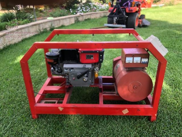

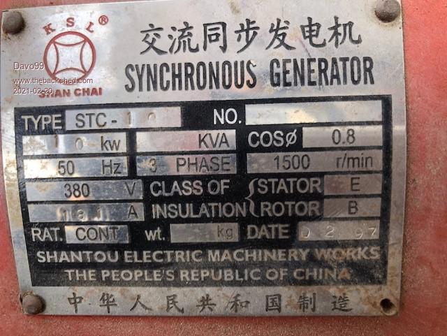

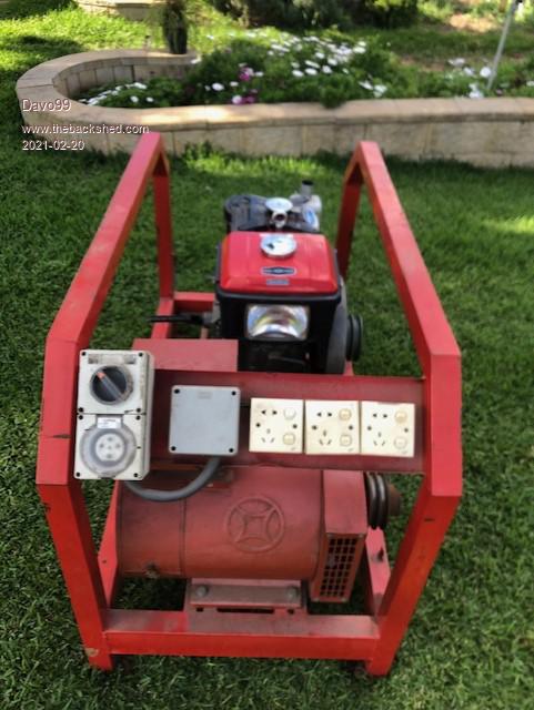

The generator is pretty much what I wanted alternator wise and is 3 phase. These things are so hard to get and rarely come up and never within decent distance of me.
Did a bit of wheeling and dealing and owned it.

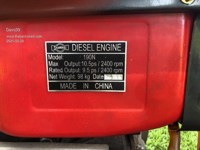

I notice there is no stamping on the weight specification.  The engine is around 100 Kg and it's clear by the balance the alternator is a lot more than that.  I tried looking up the weights but they seem to be like a lot of other Chinese specs, whatever sounded good to whomever was writing the info at the time. Seem to be anything from 100 to 150 Kg and I'm determinately leaning to the heavier side just like the thing does unless I put the forks right to the alternator end of the frame.

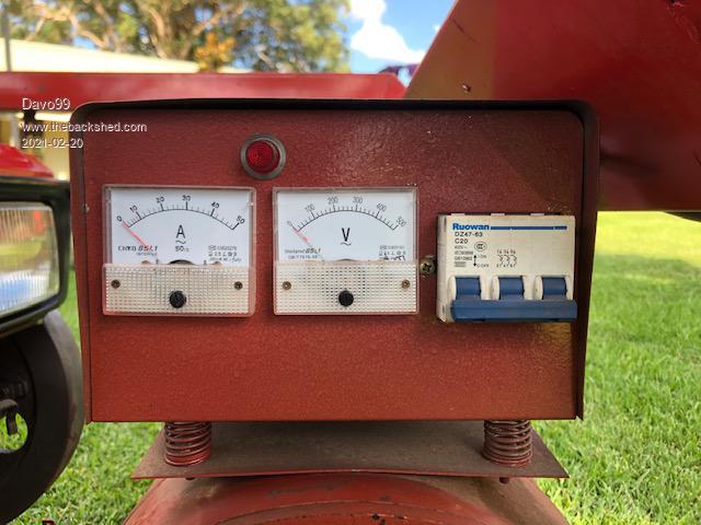

It's wired for single and 3 phase output which is good and saves me the trouble.
I noticed the bearings are a bit noisy even though the guy said the thing was new and had only done a few hours for testing.  I'll pull them out and look at greasing them or putting something better in.  Maybe the Yak fat they factory lube the things with has gone a bit dry?
The engine, thats something else.
I bought another one this week  oddly enough but it was just a little 4 Hp watercooled. Even that weights 60 Kg so I think they are under rating this one bulk wise.
I tried spinning the thing up as it's hand crank only.  Admittedly I'm only a little bloke at 6'3 and just got below 110Kg and fitter than I have been in a while but it would take a much better bloke than me to spin this thing into action! I can't imagine how some little 50 kg Asian bloke would do it. Come to think of it, I can't Imagine how the strongest, fittest people I have known would.
I thought it must have a lot of revolving mass in the alternator so I slipped the bely off and if anything it made it worse.  There is still definite compression resistance with the decompressor activated but instead of the alternator smoothing it out, you can definitely feel it. They guy seemed impressed when I said this engine is too small to get full power out of this alternator, I guess you down sized it on purpose but what will it pull? He said it will do 8-9 Kw and explained that a lot of the people where they were used had no Idea of power consumption and would plug every appliance in the village into the things so the alts had to be safeguarded.
The guy said he still has alternators and electric starter kits for the things so I'm interested to get one off him. He said the fuel tanks had to be replaced with smaller ones to make way for the ring gears on the starter flywheel  But no problem to me. I'll just mount the tank on the top of the frame and extend the fuel line.
I am still wondering how in the hell they ever hand cranked these things though?
At first I though maybe it hasn't been started in a while and maybe there is a bit of fuel flooding the thing and some other pondering but then I remembered my 12 Hp Kubotas I have in the shed that these things are knock offs from are exactly the same. I can't hand crank them either although I can start the big lister with no problems at all.  Soon at these things hit compression they just stop cause you can't get them fast enough to carry through and fire.
Maybe the Horizontal cylinder types just don't have enough throw on the Crank handle? The Lister crank is huge in comparison to these things.
My other thought was to set up a Pony motor on the thing to spin it all up with a belt tensioner for a Clutch and then back it off once the big engine is firing.
None the less they are a pretty well packaged setup although I might change that too.

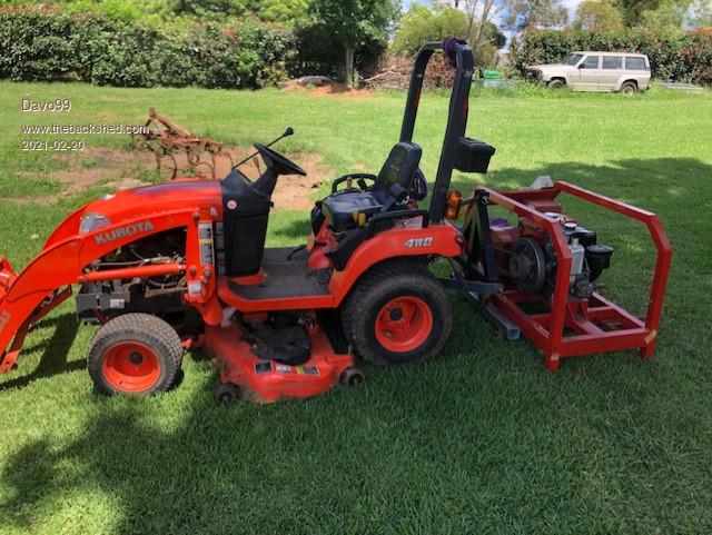

The frame makes the thing nice and easy to move around on the forks I made for the 3 Point of the tractor.  I knocked that up quick and rough as could be out of scrap I had laying around and they have proven to be one of the best things I have done in a long time. The forks are just 30mm This wall tube but they haven't bent to my amazement. I'm thinking I might stiffen them up bu welding another pair of half length  Tubes inside the middle area of where they are now. That will make them a bit wider closer in as well.
So now it's time to clear a space in the shed and set thing thing up properly.
That said, No idea what that is yet.  I don't have 3 phase up the shed and not sure I want to spend the $1200 plus the digging and stuffing around it would take to put it up there.  I did Build a ripper for the tractor the other week to lay some Drainage pipe but I'd have to go under/ through a wide path and under some  stone edged garden beds etc  to do the cable as the existing conduit is only 25mm. Of course!
It would be easy to enclose the genny in the shed and put a proper muffler and air cleaner on it to shut the thing up.  Alternately I could keep it mobile, maybe even put some wheels on the thing and trailerise it with weather protection and some sound limiting and bring the thing down If I wanted and just plug it in.
So many options and I'm terrible at making decisions. :0(
First thing I might do is drag out the Kubota engine with the electric start and put that on so I can turn it. I'll also see just how close these copys are and maybe take the flywheel, tank and electric start off the spare Kubota and put it on this engine.
The knockoffs are either Kubota or Yanmar and knowing my luck, I know the engine on there will probably be a Yanmar clone. I think they are the most popular in knockoffs.

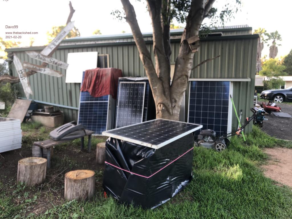

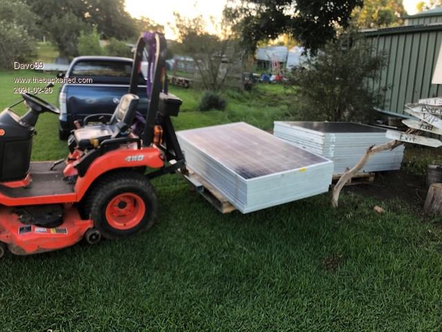

On my way home with the engine, I came across a lot of panels that have come off a factory roof. About 800 250 watters.  Unfortunately, and this irritates the living Crap out of me, the installers have cut a lot of the cables. Not just the ends off but to about 4" from the junction box.  I can't stand lazy tradesmen that do this but that's another rant.
Anyway, went back and Picked up about 50 of them so far, most that have the leads and a few with one connector missing but a decent length I can put another one on.  I can see I'll get 100 Out of the pile and beyond that, don't know.  Have to work my way through the pallets but the first 2 were all cut off. Different people doing them I spose.
They are good quality panels and I'm pretty sure I know why they were taken down. Probably falling output...... From all the damn Lichen on them!
They probably could have had them cleaned and the things would have been fine.
Anyway, I'm not complaining other than about the cut leads.  I might Pick 50 or so of them up anyway and use them for the carport roof beside the shed I want to build.
I'm putting these things on pallets so I can move them round easy and not push the shed over from all the ones I have stacked there to go on my own roof... when I can bribe my daughter to help me again.
I had someone come round and buy a bunch of other panels I had so that was a quick return against the cost of the Genny.
The solar table with the black plastic underneath is the Genny. Going north to visit and help my Dad for a couple of weeks so It's going to have to sit there till I come back.  Also the wrapped it up apart from weather proofing was The mrs Doesn't know about this latest acquisition as yet. I did tell her I was going to buy a Big Genny this year but probably wasn't expecting one so Quickly. Neither was I actually by a long shot.

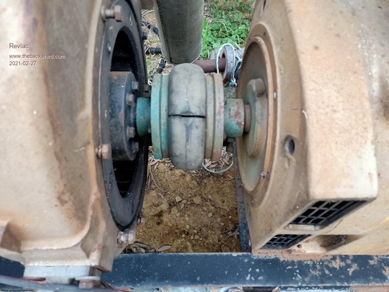

My farther and I built a coupling for a genset we were rebuilding, the original motor had blown up and the genhead had a crook Bering.
We got hold of a good size old truck engine and coupled her up to the 63Kva or 68Kva Stamford, it has been going well for years.
Years ago we had this little 3 Cylinder Lister diesel with a 14Kva genhead, it had a great big cast coupling with a thick flexible rubber plate in the coupling, that worked well for many years.
It was getting on a bit and we thought we would try the big lathe as it could do with a service run to keep all the gears lubricated, the lathe motor was 15HP DOL start......(there's your first clue).....hit the start button on the lathe and the 15hp electric motor started to turn, then the contractor tripped and could here the geny loaded to the sh$thouse but picking up speed again, after hitting the start button again everything got up and running ok.
Nice, first time the big lathe had run, then we pulled the 2 way clutch for a higher spindle speed.....HUGE BANG from the generator shed and black smoke filling the shed, waited for the smoke to clear and had a look in the generator shed, Lister was still running nicely at 1500Rpm, shut it down to find that big coupling had blown to bits, split at the key-way on the shaft.
One big piece of coupling hit the fuel tank and caved the side of it in, the other piece hit the wall and the 3rd piece we never found, even after cleaning up the place and moving out.
We worked out later that the other big piece flew out the side of the shed past the carport past the driveway and landed somewhere in the neighbours bushy yard, couldn't have gone anywhere else.
Since then we built some of this coupling for the genset, I think the rubber tire part is fenner dodge , its done another 20+ years on that and still going.

There is a little flexible metal cover on one end of the gen head where the brushes are with one of those clamping latches to Pull it tight. VERY easy access to the brushes.
I'll have to try and get some spares off the guy I bought it from who said he had some.
Also see if I can get the electric start flywheel and starter motor for that thing or I'll put one of the electric start Kubotas on it.
Not sure but what I have read seems to suggest an AVR could be fitted. I have a couple of universal types sitting in the cupboard I was given years ago by my BIL who bought them for a generator on his battle ship that wouldn't fit. one is a 12 Kva so should be about the right size.

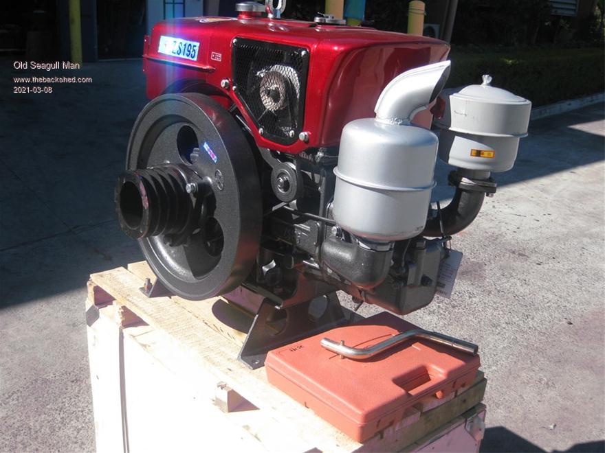

Nice one old fellow,
there will be some sad Lister boys, knowing you have gone to the dark side.
I cant speak to loud, this is one of my three.
plus a C/S 3hp and a TR 2
Andrew

We have 2 Lister air cooled engines driving generators 1 single phase the other is 3 Phase, the other big generator is water cooled, needs some work.
