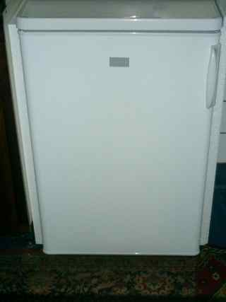

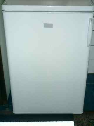

So it was time to go shopping for another fridge. Here she is, the new Zanussi ZRG616WS, in factory condition:
Only 152 liter (5.5 cubic feet) but large enough for me. No freezer compartment as I don't need it; have a separate freezer for that. The manufacturer states that it uses 151 kWh/yr, i.e. .41 kWh/day. Compare that to the 2.3 kWh/day that the old fridge needed. The fridge cost 180 E (including 17 E removal tax, err, 'contribution') and as electricity over here costs .22 E/kWh, break-even point is at 14 months. This is assuming that we don't soon get another electricity rate increase of 27%, as we did last July...
Now, 410 Wh/day isn't too bad as-is, yet it can always be made better... But first I decided to make a few measurements using the kiloWatthour-meter before embarking on the insulation project. For a few weeks I measured electricity consumption at various thermostat settings. The results of the measurements are in the graph further below.
At 5 deg. C (setting '4' on the thermostat) the fridge uses 304 Wh/day, quite a bit less than the manufacturer's stated energy usage of 410 Wh/day. That's the first good news: the fridge uses 25% less energy than stated.

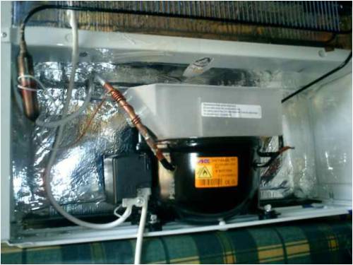

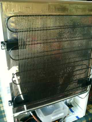

Ok, now that we have a baseline for comparison it's insulation time. First thing added was a radiant barrier between the fridge cabinet and condensor coil, to radiate the heat from the condensor away from the cabinet. Same with the compressor compartment, where more radiant heat barrier was added:

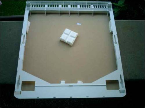

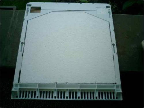

Then, as I took the top cover of the fridge off I noticed this was completely empty, apart from a small styrofoam spacer. This is 23 mm of space that the manufacturer could have easily filled with some insulation. Amazing. Even plain styrofoam (with a thermal conductivity of 0.038 W/m.K, which is mediocre as far as insulation goes) would have been better than absolutely nothing.

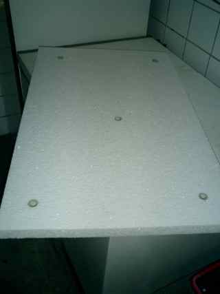

So I took a sheet of 30 mm styrofoam and cut it to a thickness of 23 mm using a hot-wire knife (being powered by an Oztules PC-PSU conversion... but don't tell him, he may want royalties), then cut it to size and fit it into the lid. Presto. Another 23 mm of insulation on the top. Admittedly, the top of the fridge is the warmest part so insulation will have the least effect here, but every little helps, I suppose...

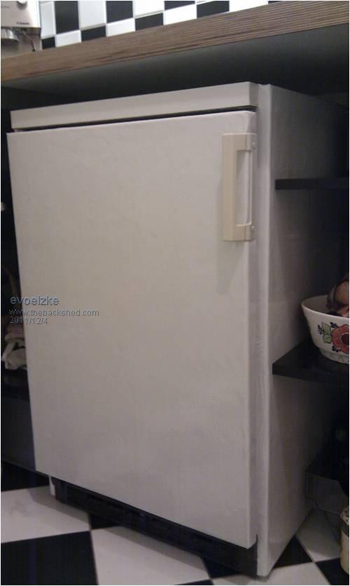

Now that we have insulated both the rear (radiant barrier) and top, it's time to look at the rest. The door won't be insulated as I don't want the fridge to look as if cousin Bubba and I hacked it. The door will remain as is. To the sides I added sheets of 30 mm styrofoam, cut to size. As I didn't want to glue the insulation to the fridge (for easy cleaning and for warranty issues) I epoxied in a few 12x6 mm neodymium magnets. These hold the insulation to the fridge just fine:

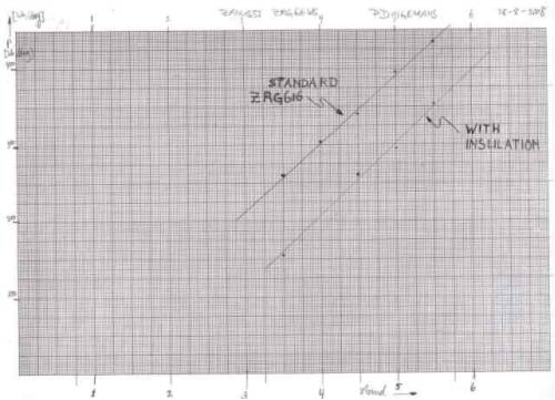

The resulting energy saving of all the extra insulation:
After some measurements it turned out that at a thermostat setting of 4.5 the new energy use is 250 Wh/day, which used to be 340 Wh/day in the unmodified situation. So it turns out we're saving about 90 Wh/day, or 26%. Not too bad! That's another 33 kWh/yr extra shaved off, or about 7 E/yr at today's energy rates. Considering that it took about 2 E worth of styrofoam and a few leftover magnets... not too bad results, me thinks. It means break-even has been lowered to 13 months. Now, these modifications took me a few hours to make and not more than 3 E in materials. But if done by the manufacturer it would take only seconds to install and mere cents in material, but reduce energy usage by another 26%. Amazing that this isn't done at the factory.

Robbo, notice that this particular fridge has the condensor coils on the outside, not in the walls. I must say I've never seen one where the condensor coils are -not- mounted on the rear-outside, but I understand that it's pretty common in the US to have the condensor coils in the sidewalls. Why ? Beats me. Thermodynamically it's a stupid thing to do.
But you're right, if the manufacturer had mounted the condensor coil in a sidewall it would be very unwise to add extra insulation over it.

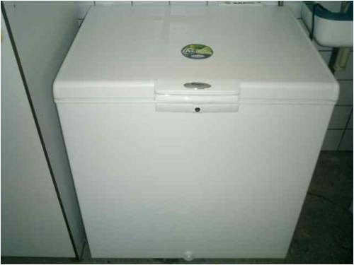

Ok, the next part of the energy-reduction quest... Just brought home a new freezer, energy class A+.
Manufacturer claims an energy use of 223 kWh/yr, or 610 Wh/day. The current freezer used 2.3 kWh/day which, during the past few months, I managed to reduce to 1.7 kWh/day. So the new freezer should save at least another 1.1 kWh/day on the energy bill. With some extra insulation hopefully a bit more. I'll report back here on the results of the freezer insulation project, after I've gathered some good data on the energy use in the as-is condition.
