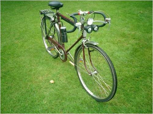

Not really a story about windturbines but this may still be interesting for the odd reader who regularly uses a bicycle. I claim absolutely no originality for this project, building bike headlights out of halogen garden lights goes back at least a decade but it's still a useful project.
After reading a bit about DIY bike lights made from garden halogen lights I decided this would be the perfect solution to my bicycle lighting problems. After having been blinded by oncoming cars too often (some don't feel a need to dim for cyclists) and, on occasion, having ended up in a ditch because of this, it was time to do something about it so the same problems wouldn't occur during the coming winter rides. That, plus the 2.5W dynamo-powered headlight just doesn't cut it in the part of my commute through a forest.

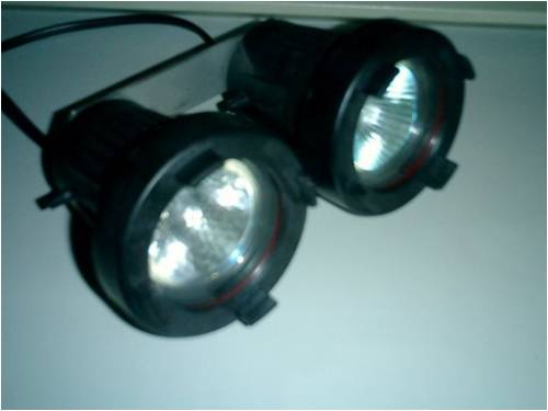

The actual headlights are two waterproof garden lights. These are pretty cheap, use 12V (via a transformer), waterproof and, best of all, use standard MR16 bulbs which means it's easy to replace them with exactly the right bulb for your application, as there's a large selection in MR16 bulbs in all kinds of powers, beam widths, etc.
In this case I opted for two lamps, one with a 10W/38 deg. bulb (the 'low' beam), the other one a 20W/24 deg. bulb ('high' beam). The high beam is only intended to signal oncoming car drivers who neglect to dim their high beam. Now, the trick is to not run these bulbs at their rated 12V but at slight overvoltage, in this case 14.4 V (20% overvolted). This of course drastically reduces the lifespan of the bulbs (from 4000 hr to 600 hr) but that's not much of a problem as these bulbs only cost a few dollar. However, by overvolting, we get relatively much more light for only a little more power use. In other words, we get better efficiency (more exactly: efficacy), i.e. more lumen/watt. By overvolting by 20% the efficiency of these halogens becomes better than even the very expensive HID lamps. Of course, the price is a drastically reduced lifespan of the bulb. This link gives much more technical information:

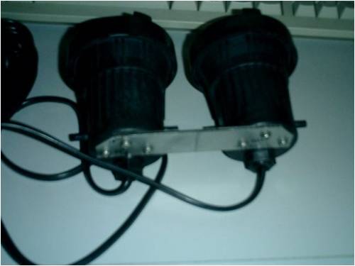

I welded a small bracket out of stainless steel to mount both lights to the bike. Looks pretty impressive when viewed from the front :)

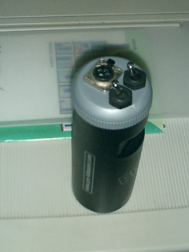

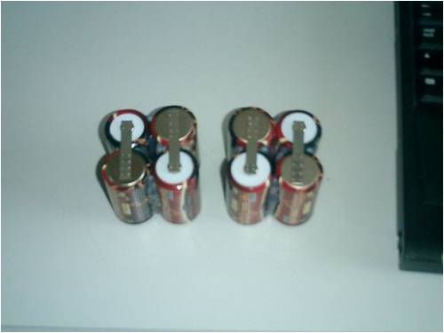

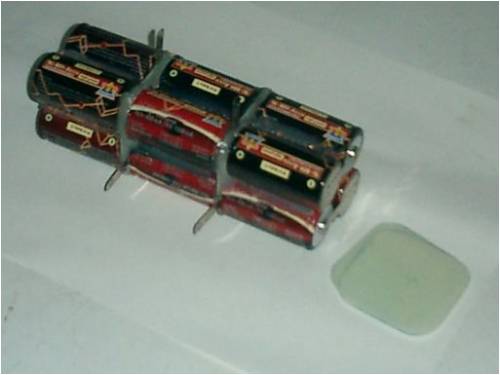

The batterypack to power it all consists of 12 NiMh C-cells of 4000 mAh each for a total system voltage of 14.4V. The batteries were attached to eachother with hotglue, then 0.18 mm thick nickel strips were spotwelded in place (hurray for the CD spotwelder!). More hotglue was added, wires were attached and everything packed in heatshrink. Then it was all inserted in a drink bottle with wide mouth, the spare room stuffed with styrofoam packing chips.
In the lid I installed a power connector, XLR in this case (unfortunately, not waterproof, but hopefully isn't an issue as the batterypack will not be left out in the rain; if it's outside the XLR plug will always be inserted) and two large waterproof toggleswitches. The large switches are handy in case of cycling with gloves on. The switch for the low beam is normal toggle, the one for the high beam is momentary toggle, as it's intended only for signalling (it draws about 1.8 A out of the 4Ah battery so not recommended to run the high beam for very long). The low beam should be able to run nearly 5 hours on one charge, the high beam about 2 hours. More than enough for my purposes.

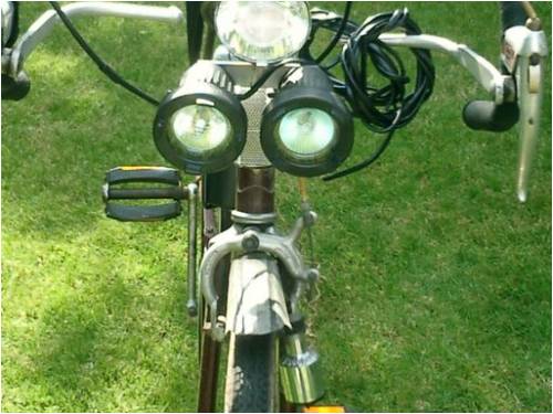

Here it is all wired together and installed on the main commuting bike (I'll admit, she's a bit old (1979), 23 years in my possession and doesn't look like much but by my estimate she has done 45.000-50.000 km, about once around the world):
The tasting is the proof of the pudding. Here are two pictures made with the low beam and high beam on. The low beam provides plenty of light for normal cycling in utter darkness, but the high beam is like riding in daylight. One can spot cats hundreds of meters away...

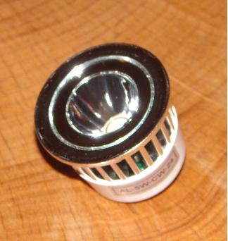

here is a photo. The units consume 4.5W@30VDC and 3W@10VDC. The units are rated 5W at nom 24VDC. They are comparable light output to a std QI downlight lamp. They hurt your eyes at several meters when looked at directly. There is a good heatsink on the LED and they are rated at 100000 hours life. The ones I have are probably made in china.
This is one of the lamps.

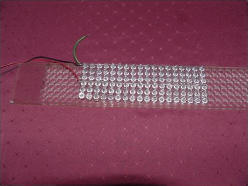

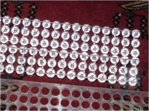

So I built him these things.. here is the jig with about 108 diodes in it. It is only half loaded at the moment.
Then you pop them out with only the resistors holding them together like this.. (this is a bad example as there are two three strips, usually they are solid 6 strips)

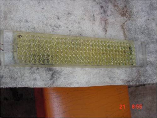

Then we use 12mm acrylic and mill out a basin 9mm deep, put the 200 leds in it, and pour in 4mm deep of west systems epoxy. This turns it into a solid light block, capable of being bolted to the underside of the boat to light up the water beneath, some on the back of the boat under the water line etc. They are indestructable, water proof, extremely bright and do the job with very little power drain for the light output.
They look like this:
No fancy current limiting circuits, just resistors. No electronics under salt water. I have trained the fisherman to make their own now.
