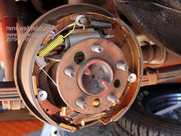

This is what I am familiar with (pic ripped off net)
What are you tightening to cause a lockup?

A picture of your brake would be helpful.
I always did mine one side at a time because of the multitude of different ways that they could be installed.
