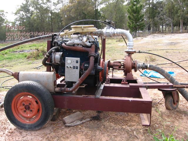

Diesel powered water pump.
Had the need for a decent size water pump years ago and these little petrol powered fire fighting units weren't up to the task, also had some single phase electric pumps but was costly to run all day.
The idea was to shift a lot of water quickly and efficiently without loosing as much in evaporation.
Already had a good size pump, Dad and I just needed something to drive it, found an old diesel car engine Nissan SD22 in very rough condition cracked head etc. other bits missing, but fixed it up a bit.
Found a base frame at the local TIP, mounted the pump and motor on it, made up a mount to fit the pulley on to the flywheel.
No need to do anything about a governor, the pulley is about 2:1 ratio so the motor runs at about 1500rpm more or less depending on what water pressure is required.
This was 17 years ago
Still use it on occasion.
Some after thoughts.
A 3 belt pulley would have been much better than running just 2 belts.
The radiator is a bit of a waste, would do better with a heat ex-changer, using some water from the pump for cooling.
Just a working example.
That muffler has rusted off long ago, not so noisy.
Edited 2019-08-16 19:24 by Revlac
