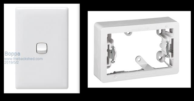

Another one I saw was a portaflood that had been screwed to a carport bargeboard to light up the back yard, had a 'standard' hpm/clipsal style INTERIOR switch on the back wall with a interior standoff box- out in the open- not under the carport or anything!!
Worse it was wired with the grey/grey with black strip SPEAKER wire!!!
Directly from the HWS power box, to the switch to the portaflood...
(the 150w portaflood was understandably rather dull for some reason...)
How it didn't electrocute someone or burn the house down...

Not even an IP rated outdoor switch?
Double-crikey.....and no earth circuit if it was speaker wire then....

Nope, just the standard interior single gang switch- badly uv damaged to boot (it had turned a distinct yellow colour, and the plastic was crumbly to the touch)
Oh and to add insult to injury, the light grade speaker wire (the stuff you get with a basic radio cassette back in the day- that thin grey figure 8 stuff)was attached with what looked like carpet staples- which had cut deeply into the plastic insulation...
These old style ones
on the back wall- totally exposed...
eta- and being hooked to the HWS, it means it was probably a minimum 20A supply breaker- or more likely a fuse in an old weatherboard place like that- certainly no earthleakage breaker, being on the HWS- if it even had one fitted at all
