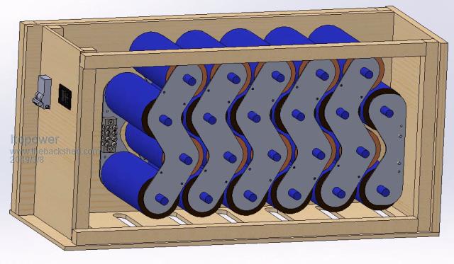

And this is the internal layout
How many cycles these have had so far, unfortunately no idea. They are still around 90Wh per cell (100%) from a previous test on the whole stack so even though they are 2015 and 2016 cells they are still all good.

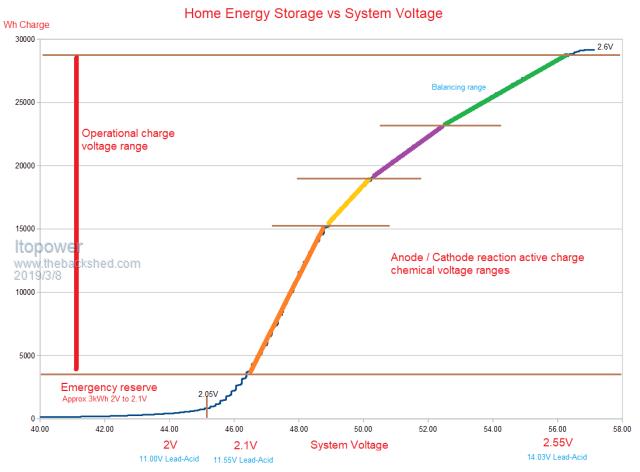

This is what the V to W looks like for a 28kWh setup (6 packs added since then so now 36kWh at 2.6V)

Man, you done so much better than I did.
I paid 3 times that for smaller cells and it took 9 months to get them. Looks like I shouldn't have given up so easily, I was probably a year or two early.
thanks for the graph. that is on thing that stands out is both LTO and LFP are a good voltage match for inverters, way better than old EV cells.

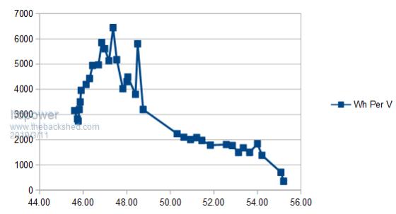

This is an actual discharge test from my pack when it was 26kWh, rather than an individual cell test.
The base axis is busbar voltage and the left axis is Wh per volt reduction. I think this starts to show the actual performance of the cells in a more usefull way.
The noise is due to me switching 1-4kW of heaters on and off while trying to discharge the pack in a day.
