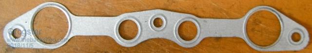

How the hell do METAL gaskets work?
The softer ones made from cardboard, gasket paper/card, or the manifold gaskets that are metal but with a compressible inner material I understand.
The all metal ones make me uneasy. Metal is not compressible when used as a gasket, so how the hell does it actually seal?
Take this metal gasket:
It is from a 1979 Vauxhall Chevette, but was also used in the Vauxhall Viva's, and the Holden Torana's(as they had the same engine).
I note the ridges around the holes. They squish down flat, as old ones taken off engines don't have those, they are just flat. That must be part of the thing.
This intake gasket makes me nervous, as the two big holes are the intake ports(which is fine), but the two medium sized holes in the middle are water-jacket holes for water from the cooling system to heat the intake manifold. How can metal seal against water? One would think that water would instantly leak from around those holes, and - God forbid - be sucked towards the intake ports. That would be REALLY bad, as trying to compress water in a cylinder will blow holes in things internally - not good.
I would love some mechanics on the forum to reassure me and explain to me how a metal gasket can possibly work as a seal where water is concerned. Edited by Grogster 2018-11-06

The crush-ring fills in any deformities in the mating surfaces and provides a seal against gas etc.
From memory, the material of the crush-ring in your picture is bulked up by the ring making process. ie, when in the press they punch the holes then press the rings, slightly enlarging the port hole and providing a small amount of crush material to make the seal.
When bolted together the indented raised ring crushes, the inner port hole remains the same size.
new gasket 2cm hole, used gasket 2cm hole, crush ring now flat.
Some also used an etched soft copper layer or similar addition to the indented ring to enhance the seal.

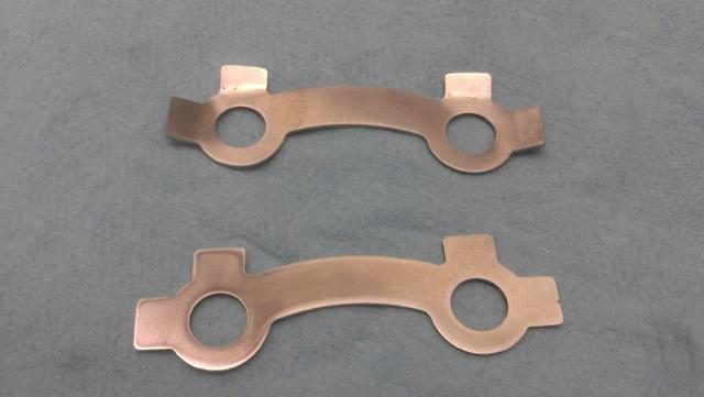

Hi Tony what sort of car you did on gasket as my ford territory tubro has replace casket fews time as 2 or 3 bolts come loose mosty on number 6 cylinder exhaust thinking drill hole on bolt head and wire up like use aircraft piston engine sometime i get mad thinling about weld the bolt on the mainfold but not yet
Posted: 08:09am 10 Apr 2019
Drilling high tensile bolt heads for safety wire is not going to be that easy, but if you can do it, its an excellent solution.
Something a bit easier might be home brewing some bolt locking tabs from thick gauge sheetmetal.
I only use grease on gaskets that have to seal against air or water.
