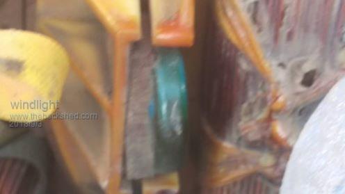

My old faithful has failed, now it has had numerous capacitors in it's life but this time the trouble goes deeper. Brush less generator Voltage comes up but fails on load, I assume the two blue discs on the rotor are diodes. I cant quite make out numbers in situ but of what I think I can read is s20k below that 420???. Any advice before i take to it with a soldering iron.

I'm not familiar with that particular model, but the one here I think it has 1 diode, it also failed, replaced that diode and it has being running ever since, well occasionally it dose not excite, just drop the revs to idle then let it go again.
I think the diode were high speed?
