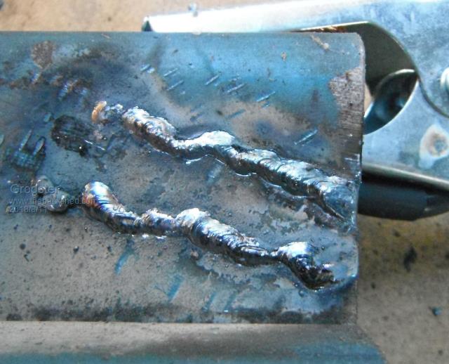

Here is my first attempt at lines. All I am trying to do here, is just weld acceptable lines. I am not actually trying to weld things together at this point. Once I have welded some lines, I will grind these off with the angle grinder and do more.
I currently suck, so please don't be too harsh with your comments!
The bottom line in this image was my 1st attempt, the line on the top was my 2nd attempt. I need lots of practise, but you have to start somewhere!
I am still having problems with the electrode sticking to the work-piece.
Once I strike the arc, so long as I don't stretch the arc out so it stops, I can do the lines. I am using 2.5mm electrodes. Packet says 70-100 amps. At 70 amps, they were sticking badly - probably too cold. At 80 they stuck less, and at 90 amps they seemed easiest to strike and run with.
I find that once they stick, to get them off the work-piece, you have to be violent with them, and that knocks some of the flux off the end of the electrode, and then makes them really hard to strike on the next attempt. If I get ones that stick tomorrow, I will use some big wire-cutters to cut the electrode back so that we have a full surround of flux, which probably would aid in striking the arc, yes?
