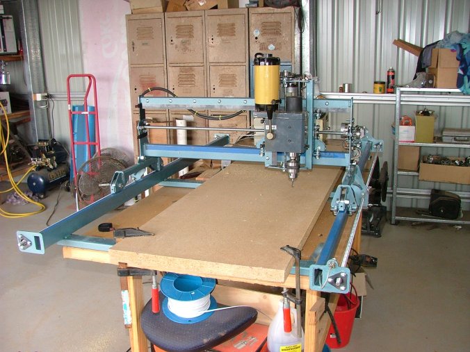

Well it was a hell of a project, took about 6 months of design, redesign, and scrounging for parts. Buts its finally working.

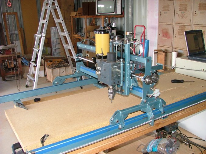

Has a work area of 1200mm * 600mm * 150mm. Below is a closer view of the gantry.

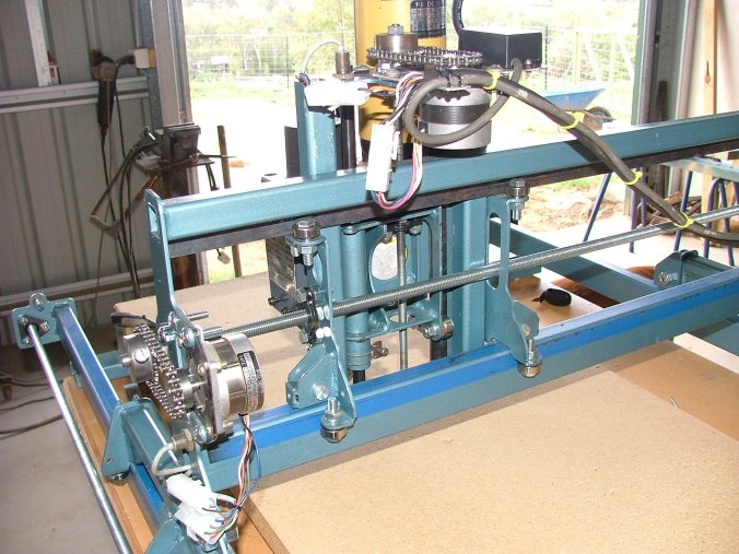

And around the back, you can see the lead screws and stepper drives. Using chain and threaded rod is not the best way of doing this, but they are cheap.

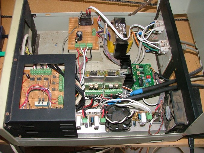

The electronics are housed in a old PC case. I want to upgrade the stepper driver boards, and will need more room so will move to a bigger case in the future. Its not pretty, but it works. The whole thing is driven from a PC using KCam software.

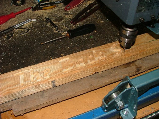

The first serious route job on a bit of scrap timber.

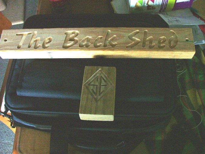

And the results.
The plan is to use the router to make some windmill blades. Well the router is working, but I have a lot to learn before I start making blades. The software uses G-Codes, an industry standard. It will also import DXF files. To rout in 3D the code needs to take off material in steps of about 2mm deep, so a windmill blade would require several dozen passes to get the depths.

Is that setup using the stepper drive kits from oatley that they make for cnc's?

 genius, well done - the router head -whats that from?

Chris, I started with 3 of the Oatley stepper drives and built my own current regulators. I had problems with the X axis drive ( the one that has the most work to do ) so I ordered a new stepper motor and drive from Ocean Controls ( www.oceancontrols.com.au ). The stepper drive has its own chopper current regulator and can do half steps. The X axis now runs a lot better, the big stepper has lots of power. I will order another motor and drive from Ocean in the near future for the Y axis.
I use the half step function on the new drive, runs a lot smoother. If I could afford it I would get some microstep boards. Very smooth, and very expensive at about $300 each.

Nah the router head itself was the milling attachment from my lathe. I never used it, and it often got in the way when using the lathe, so I thought it would be good on the router. It has a electronic speed control and a 2 speed gearbox, plus a 500 watt motor, and its quiet compared to a hand router. The stepper motors drive the router head around the table.

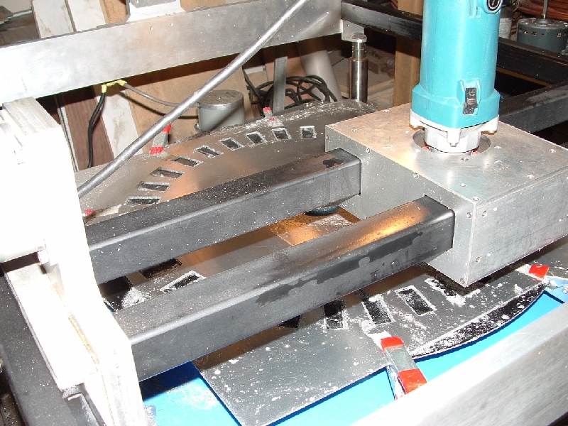

Gizmo, Joseph here. Here is a picture of my cnc machine I built last year. I am cutting 6063 aluminium. A template for a magnet rotor, first cuts on my rotary table W bed.
"Failure is an option."

Glenn I'm a little eunsure of your preferred stepper motor control scheme. Did you settle on the oceancontrols controller/interface? If so what interface do you use? I was looking to us the serial port version, oceancontrols stepper driver and KCAM. Is this all the requirements for brains?

I ended up using the Ocean Controls stepper driver, the one with half steps and current control, KT-5191. And for steppers I used their 23HD803 motors. I drove the stepper drivers direcly from the parallel port. Other than that all you really need to get up and going is a good power supply, at least 25 volts at 3 or more amps.
I've read good articles about the serial interface board, but havn't used it. Not sure if KCam supports it, as the KCam author had a family death a year ago and is no longer supporting the software. Bummer, its a good program. One of the biggest problems with using a parallel port is the PC spends most of it time sending out the signals for each step, but that serial interface means the PC just needs to send the basic info out, and can continue working on the next set of commands. The KCam site also has something called the "Max Stepper", which will work with KCam. If Max Stepper works the same was as the Ocean controls serial interface thingy, then it should work.
