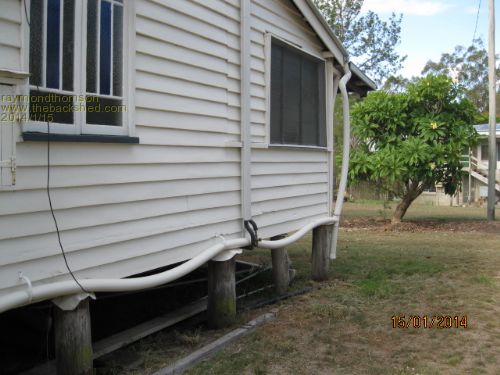

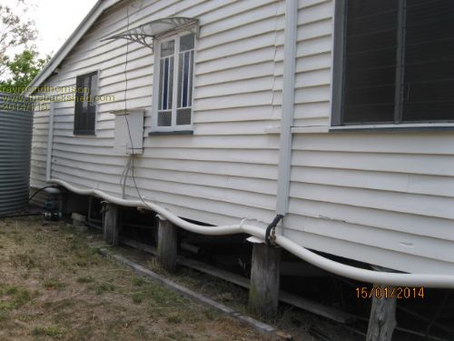

Just back from freezing in Europe I was a bit surprised just how hot it can get here when I saw the storm pipes on the old cottage. Looks as if the water in the pipe hadn't drained out, (dirty filter), and then 'boiled' causing the pipe to buckle. Unfortunately the pipe has to go this way to avoid the windows.
Just another little job for the DO List, happy days.

Wow, that's a interesting photo. I don't know what temperature PVC gets soft at, but looks like the heatwave heat and weight of the water was enough to deform it.
I wonder how many other people suffered the same problem.
Nice frangipani in the back yard too.

Looking at that, your floor stumps are say 2.5m to 3m apart and your PVC supports are further apart probably 4m. Horizontal stormwater PVC needs a wee more support (read) every m at least. I`d sack your plumber.

I am with Bryan1 on this one. Underground pipes will never get purged. My Tee piece has a drain at the bottom with a 1.25mm hole so that if there is extended dry the holding water will all drain away, but in periods of intermittent rain the large volume of water is not wasted. My mistake this time was too much travelling (!) and forgetting to clean out the filter so it didn't drain. I will also admit to needing a few more support brackets but it was always a temporary place to live while building the new house, well that's my excuse.
