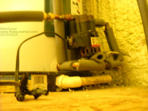

The only physical pump is the little one that makes the magic happen. It is on the return line right up against the base of the water heater in the attic space above my laundry room. You can't hear it run even if you're sitting right next to it!

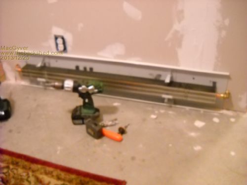

This is the "before" shot showing initial installation. All pipes are
insulated within the walls and attic with closed-cell foam insulation.

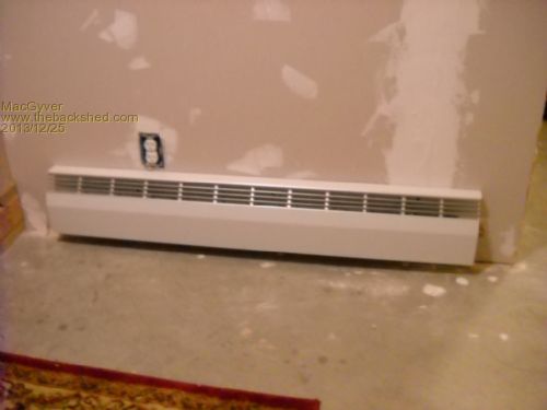

Voila'! This is the finished product mounted on an as-yet unpainted
wall. It works like a champ!
Here's that little pump. It's on a timer and cuts off a half hour before
my free-electriity window ends. That gives the water heater time enough
to recover and I get a free hot shower when I get up iin the morning.
