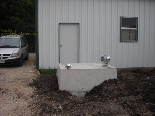

I dont know, they all do, swing out that is. I thought of the uprooted tree or flying truck perching on the door and there's a several-ton hydraulic jack and handle stashed inside the shelter. I'm in a thousand-year flood plain, so I'm not so much worried about water getting in, like in a flash flood.
Here's a shot of the thing BEFORE I enclosed it. All but the two little vents are now enclosed in a welded-steel building extension, which covers about 3/4 of it. That way, I can go through the door and enter the shelter without getting pelted with water, hail, ice or debris. It hasen't come to that yet, but that's the plan.

It looks like you should paint on it RIP MAC.

The shelter could also be used as a cool room, are you looking at this in any way?
There is only one problem I can see, are you worried that if you get a lot of rain your shelter might bubble up out the ground? I have seen many concrete pools do it when empty and the shelter seems like it may do the same.

I, as a former building official (ICBO Inspector) have seen pools do the same thing. The ground here is expansive (clay) soil and although it is a possibility, which I have considered, it doesn't seem to happen. There are shelters everywhere here in these parts and some have been here nearly 100 years with none popping out of the ground yet.
As for a "cool" room, although the ground temperature is pretty constant at about 5 feet and below (I'm 7 feet in the ground) the ambient "air temperature" in the summer hovers around 110 for weeks on end. I intend building a drop ceiling with about a two foot "attic space" in the room surrounding the shelter and expanding the interior walls the same distance, then filling the entire space with blown-in cellulose insulation in an attempt to make it cool and keep it that way.
Only trouble is, there are two air vents on the thing, which can be seen in the picture. One is an intake and the "whirly bird" turbine acts as a pump and draws air through the place, so I don't know how successful my attempts will be. I suppose I could jam foam rubber into the vents from the inside to prevent air flow, I dunno. I'll let y'all know when it is a done deal, I guess.
