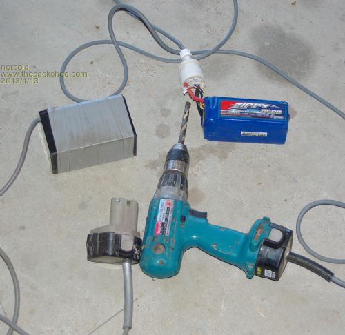

Yeah, if you wish to get away from nicd`s. Here`s a couple of alternatives. One on left is a 12v gel cell(easy to charge) one on right is LiPo4.(needs a special balancer-charger) Can vouch for the gel cell,gave many years of service. LiPo4 is only new and should be the bees knees.
Place battery in pouch on belt around waist. Pull battery apart and solder wire to terminals.
Cane toads in the freezer do not attract the blokes in white anything like batteries.
Vic

I've got few spare cords but always worried, that somebody else might plug it to 240V socket.
Practically Australian 240V plug is quite good for 12V application, as you can plug it only one way, but what is next best way to 'inexpensively' make 12V plug and socket?

  George said  what is next best way to 'inexpensively' make 12V plug and socket?
They are not real expensive but Anderson plug/socket will only go one way (provided you've wired it up right in the first place.
You can also get Oz 240 plugs/sockets with a round earth pin instead of the flat one, so it can't be plugged into 240v unless you already have one wired to 240vac.
On no account would I recommend using an ordinary Oz 240 plug - Silicon Chip got hammered on this subject when it did an article on Microwave oven PCB UV box.

That plug in photo is a Clipsal 32v polarised 2 pin plug. Would never use or advise people to use 240v plugs on low voltage. A big NO NO from a safety perspective. Even the cable is not 3 core but 2 core 2.5mmsq.
The Anderson plugs as MOBI advises are more readily available nowdays, I`d go for them.
