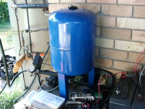

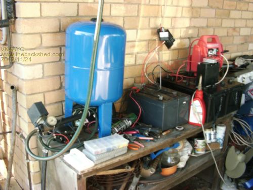

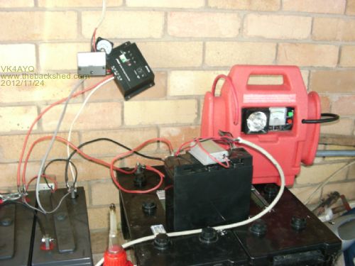

Hi All
I got some photos to show the set-up ,it is a hay wire set-up as the first thing was to prove the concept.
The pressure tank is a 20 Litre unit and it delivers around 9 litre of water.
The regulator is swinging on the wire at the moment, I am going to mount on the wall, the volt and amp meters are just to monitor what is happening and the sequences of the regulator.
The batteries are the ones I recovered a couple of years ago (battery rescue) and still going OK this application is making them better as the light cycling on the pump is better than sitting on the main battery bank, I am using desulphators on the batteries. The smaller battery is out of a gen set that sat for 12 months and was rescued also, it is a gell cell so it shows they can be used as well. I also used the battery to run my radio and CB.
I run a lead to my car battery to keep it alive as it doesn't get enough use to keep it charged and it is running all sorts of things in the car all the time and the Jaycar desulphator also draws power all the time and helps to it to go flat. The other red jump starter battery is kept on here as it used a bit of mains power through it's plug pack charger, of course I forget to plug it in most times so the jump starter was at times to flat to work properly.
The pressure controller I used was one of an old pressure pump, it has three contact sets rated at 11 amps AC so I connected all three in Parallel to make it last longer on DC, so far it is working and visual on the points doesn't show any arcing, so hopefully it will last. Set to shut off at 1.5 bar and cut in a .8 bar, it will work higher but draws more amps 7 amps as compared to 4 amps as set now.
