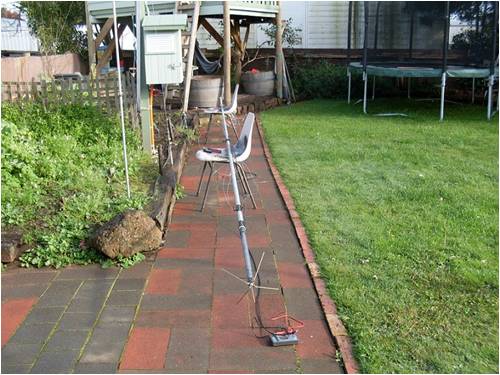

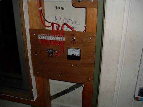

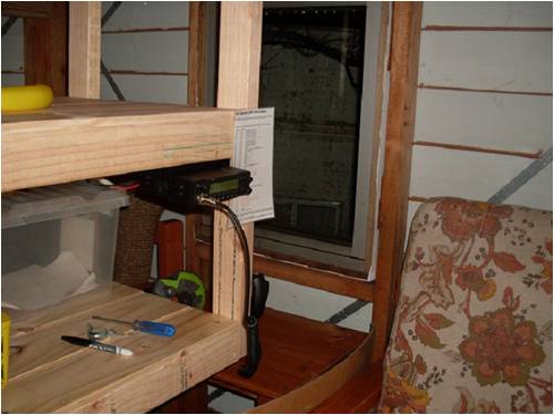

Finally the we have wired the cubby to the windmill and the antenna is being built.
things take a while to happen around here but eventualy things get done.
At the moment we have cd player lights and uhf radio wired in.
rabio is installed next to a comfy chair.

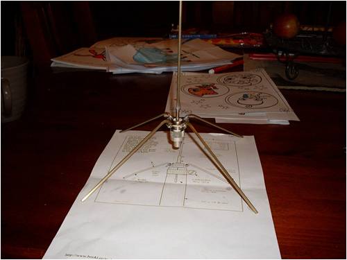

The antenna is built and just needs to be mounted on a pole.it is built to a plan identical to the one that Rob linked me except from using alumimium for the bottom elements it uses bronze welding rod. the calculator link was very handy as this plan i found does not have the correct size for our frequency in its table.

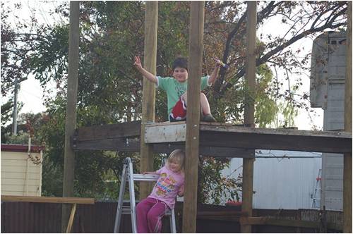

It started a few years back when it was decided i needed to build a fort platform for the kids to play on.
But from the beginning i left plenty of room for expansion and it has slowly grown over time.

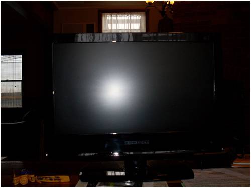

My son and I have gone halves in this LCD HD 12 volt DC TV with in built DVD player.
Soon we will need to rev up the windmill a bit
All the best Dean.

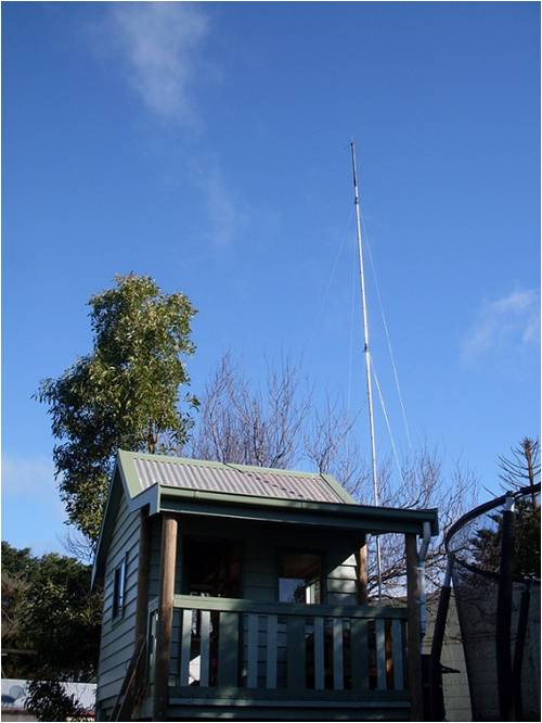

The antenna is up and we have transmited and received to 40 km so far. It has only been up for a couple of hours so our full range is not known yet but it is as good or even better than what we set out to achieve so thanks to every one who helped out.
Antenna is tested with a multi meter before it goes up and checks out OK. Early on I discovered a short in the coax conection to the plug with the braid touching the end pin socket. So it is well worth doing regular checks as you go along they can save you alot of worK and time later on.
The finnished antenna project. All up it cost us $45. For stay wires we used cheap tie wire as the pole is connected to the side of the cuby and the stays are just to prevent it swaying in strong winds.
All the best Dean.
