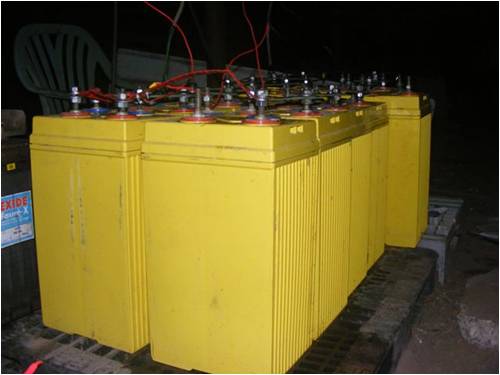

Chris, How about a picture of your batteries, looking down on the top of 'em?

Is to much water as bad as not enough. each yellow box contains 2 cells. over the last 6mths 3 cells have lost charge and have ended up with 0v when checked with a multimeter.
they have a small hole in the top which is covered by a rubber cap and then a top made of the same plastic as the batteries.
when i bought them 1 year ago, the guy said that i should top up the batteries with water. I checked them last weekend for water level which was fine and on the hydrometer the level was on the white.
To charge the batteries i have 4 123w panels running through a PL40 which says they are full around mid morning. (i read in another forum that while they say full Volts wise they may not be getting their capacity topped up)
the steel that is connecting the batteries together where they bolt onto the terminals has been ground back to shiny metal and covered with vasaline to help with corrosion. when in town today i will be buying extra diesel so i can give each bank an individual charge for half an hour to give them that saturation charge that was mentioned.
it is inconvienient as it is only one cell from a number of containers has gone.

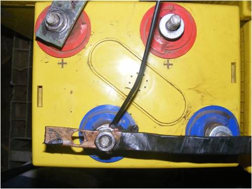

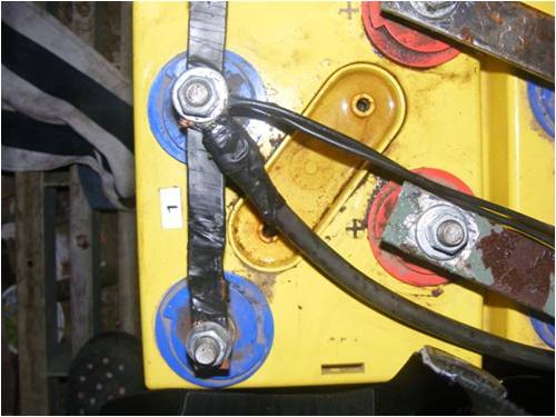

Posted: 12:03am 03 Apr 2010
I have never seen iron used for cell interconnects on a battery. I don't see joiners between the parallel strings either.
iron forms a high resistance joint quite quickly. These cells are not designed for cyclic discharge applications. More like a big UPS. Flooded cells need the electrolyte to be able to be gassed, to allow mixing to prevent stratification.
Sounds like you have some problems to sort out.

Rippa, as Gordon mentioned above, there is something very odd about your battery connections.
Can you post a picture that shows the whole top of your battery bank so we can see just how you have connected them.
There should be no unused terminals.
With the heavy currents that can flow at a battery bank its bad economy to skimp with the connecting links and wire size/ terminations. Do it well once or fiddle forever with poor connections
Also, I do hope you used de ionised water and not tap water to top up the cells. Tap water is really bad news.

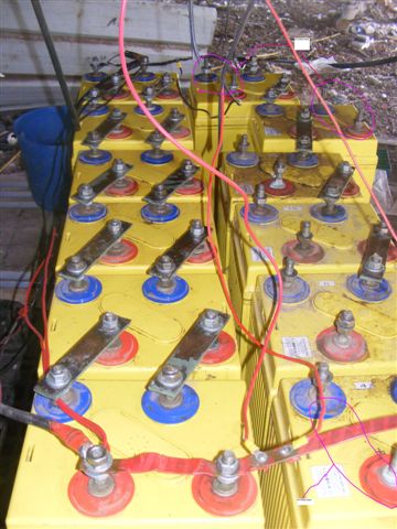

these are mine, note the parallel strings have bars across so nothing should get too out of balance
battery interconnects 2 strings 48V
Looks like batts are externally in good nick, perhaps an expensive mistakeEdited by KarlJ 2010-04-05

as seen in the previous photo they sit side by side. each row was connected in series with the metal strips and then connected in parralel at either end of the row using copper strip. some of the cells cant be used as the ones that have lost capacity to hold charge and wont make up 12v for charging. (unless i hook them up similar to the way karl has) which looks to be a better set up then mine
i had looked at using copper, i should go that way after all
will get back to everyone shortly

ps. here is the photo of how i have the batteries hooked up

Posted: 02:49am 04 Apr 2010
I think you will need to read the plasmatronics manual, on how to set the various parameters. It is available online, if you don't have a paper copy.
You should spend a little more time framing your photo, to give all the connections. We still have to guess how it is wired. The lack of cell interconnects will resusult in potential for cell imbalance, with poor connections in a series string.
This is a 12V setup, so is really only good for a max 300-500W, given the wiring you have shown.
Gordon.
PS: If you think over a 1000W is possible, then you would need the inverter right next to the battery, and it is not shown that way.
