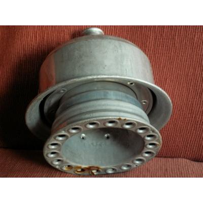

To remain true to this thread one can buy of the following contraptions (around $75 aus) and power this with a 12 Volt motor, if turning by hand becomes too much of a chore.

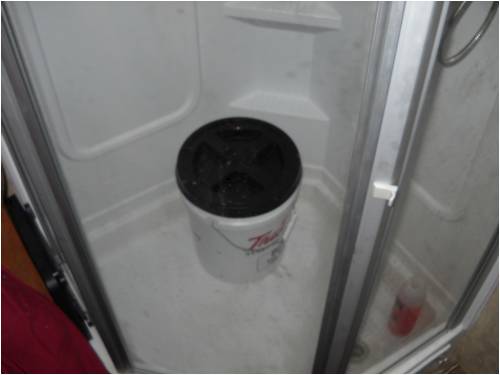

Well, it's been almost a year and a half since I got the brainy clothes washer idea and today it's finally a done deal. That's not bad; for me!
Anyway, I'm finally living my dream. I'm permanently set up in my trailer with the intentiion of "camping out" for the rest of this adventure (life). I tossed up something along these lines elsewher on the 4m, but I thought it best to start and end on the same thread, so here's what I've done:

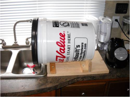

I'm using a plastic 5-gallon bucket with a "Gamma" lid. The lid snaps to the top of the pail and has a rather large screw-on secondary lid, which the manufacturer "guarantees" won't leak. It leaks. That's not a big deal for me, I just worked around the problem and use it so the lid hangs over the inside edge of my kitchen sink, with the bulk of the rest of things sitting on top of the countertop alongside:

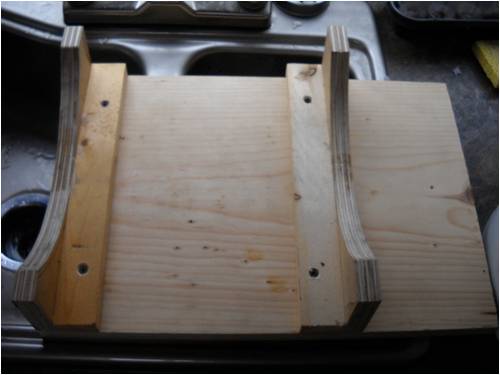

You'll see I've used a "cradle" to support the pail. Originally, I used my little lathe and built some long rollers using Delrin plastic bushings and some 3/4" copper as a tube. That worked, but it bound up every now and again, so I went to something simpler. The cradle is made of plywood and pine and is screwed together. I counter-sunk all the screw heads and ground off the screw ends on the underside so as not to snag anything or scratch my brand new countertop.

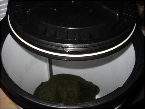

Here's a shot of the Gamma lid situation:
Each portion of the lid has its own O-ring to seal most of the water inside.

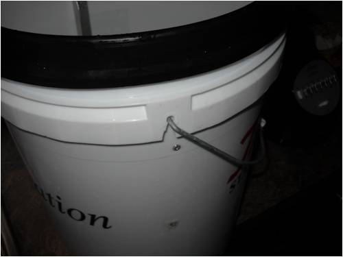

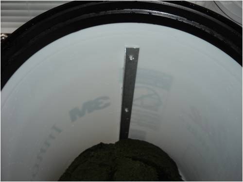

Here's a shot of the inside of the tub showing two small, aluminum paddles (angle stock) which I riveted through the outside of the bucket and sealed with clear silicon caulking. These snag the clothes and then drop them when the whole rig is rotated in the cradle and that action helps move the water through the garments much the same as a commercial front-loading clothes washer does.
This shows how I snipped out a "V" where the bail attaches to the bucket. I did that so I could easily remove the metal bail. Leaving it on interferes with rotating it in the cradle, but I need it to cary the wet clothing around not to mention to dump the dirty water after the wash is completed.
This shows the bare wooden cradle. Note that one side is flush with the edge. I did this to enable the end that leaks to hang over my sink so the drip goes into the kitchen sink drain and not on the floor.
All I do is put as many articles of clothing I want to wash up to about half full (dry) and add water to cover. I actually usually put the water in first, add the detergent and make sure it's all mixed evenly, then dump in the dirty clothes and screw on the Gamma lid. Next, I lay the thing in the cradle and roll it about ten times each way, then dump the water and do three rinse cycles. After that, I run the wet clothes through a wringer, which is down the street at the car wash, then I hang stuff out to dry. I'm in the process of purchasing my own wringer, but the silly things are over a hundred dollars, so I'm taking my time. So far, nobody at the car wash has told me to get out, but being 6'6" and about 250 pounds may have a lot to do with that. Still, I'd rather have my own.
Finally, since "camping out" is kind of a head game when it comes to "living space" I use the washer for double duty. I use it as a little "stool" or "chair" in my shower. There's not enough room for a Shrek-sized fellow to bend over and wash toes and feet, so a stool comes in mighty handy. Also, sometimes I just let laundry sit for a day inside in the detergent to "soak".
That's about it for the washer. It's not 12-volt, but it works nonetheless. Next up is an active solar clothes dryer. I know everyone is automatically thinking "clothesline" but it's not that. This will be a cabinet that collects sunlight and turns that into active heated air movement. The articles of clothing will hang inside with access through a door at the rear. I've already expirimented around a bit and have the design worked out. All I have to do now is build it. When it's flyin' I'll post it here.
Hope this helps out someone else out there in la la land (where I live). All in all, it's really pretty practical and it saves me nearly $5 each time I have to do my wash. The place I live at charges $2 to wash and $1.50 to dry, but the dryers have to be done a little bit longer than once (the cycle is too short) and then my tee shirts shrink because the heat is so high!
