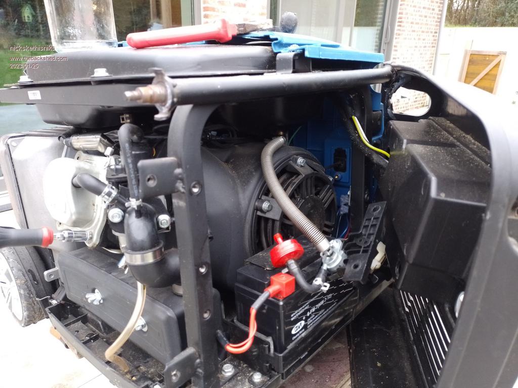

Just when I had it all together my inverter stopped working...
this is the unit (for reference):
https://www.youtube.com/watch?v=w3L1rf4lVjY
The unit is bought in december 2019 and now has about 900 working hours.
A few days ago I had the inverter running all day with a 1700W load (eltek psu).
No problems, 10h with a refill. I let it run till empty.
Next day I refill the tank and tried to start it, but nothing...

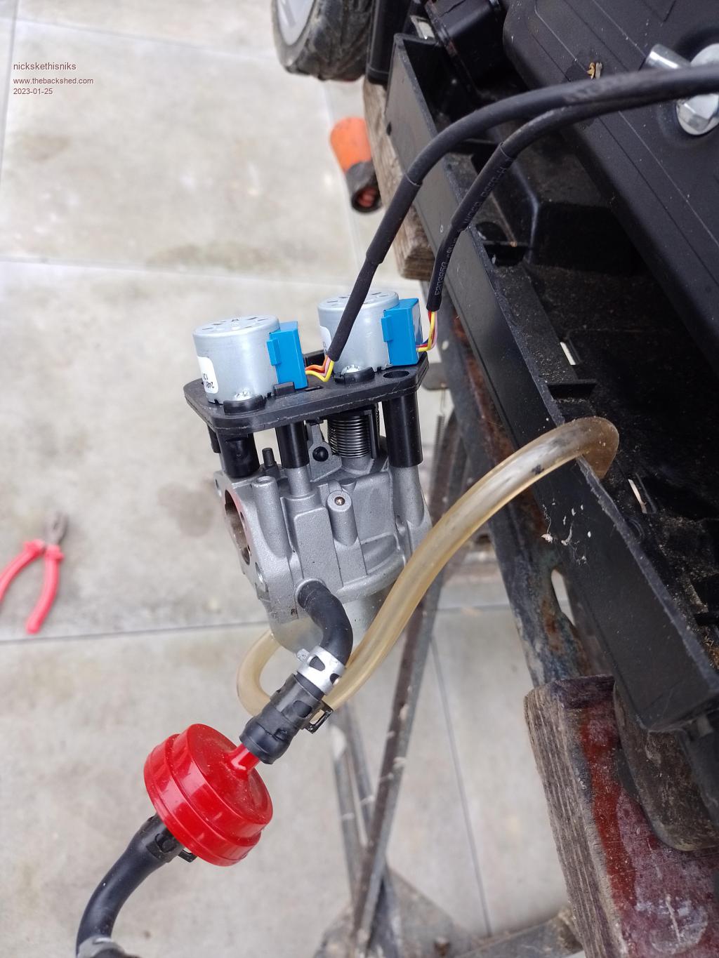

I checked and cleaned the carburator (it was clean) and spark plug (tried 2 new ones), made sure there was a spark, no problem there.
I don't know what I could do next to check. Elektric or with the pull cord made no difference for starting the engine.
I also checked the stepper motors, the choke or inlet servo worked and blocked the entrance for maximum gasoline intake.
The other for the rpm/speed control did not move but I tried all sorts of positions.

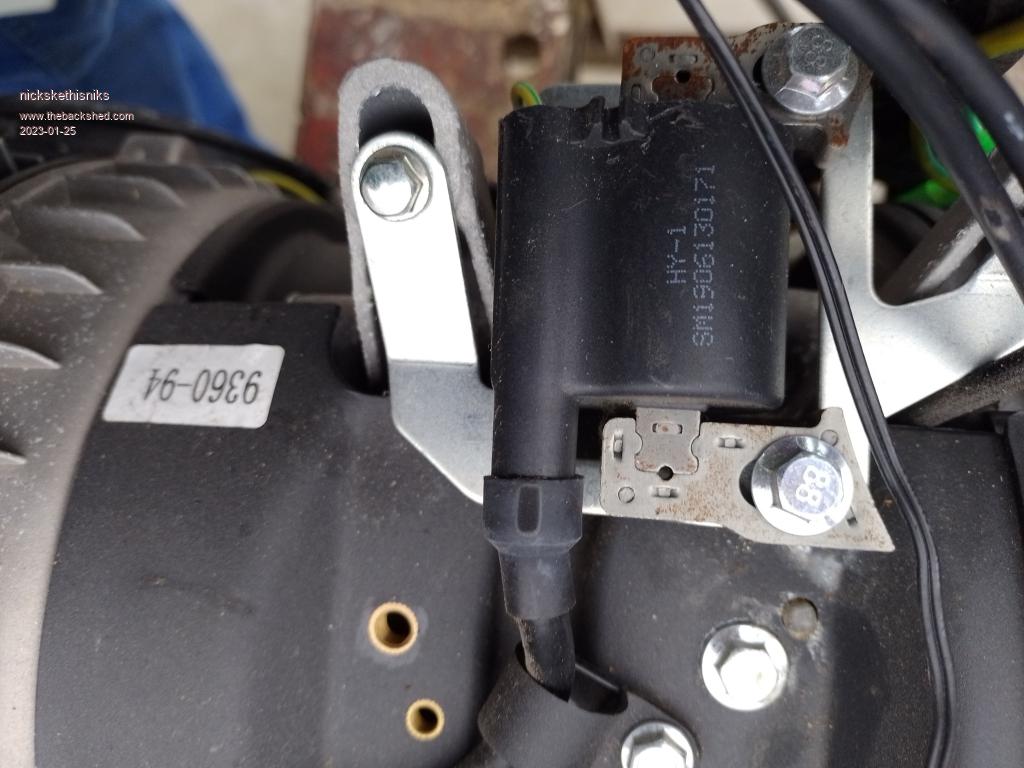

Although there are sparks, I suspect the ignition coil to be bad, the primary was about 1R (difficult to measure that low) and the secondary was 15K, if I explore google it should read more like 10K? So the coil might be bad, it might not be powerfull enough anymore to start the engine.
I think I don't here explosion so the gas is not igniting?
It's just freezing point (0-2°C) over here, I noticed the inverter needs more warming up time before I hit the switch. I could try to heat up the motor block to see if it's making a difference.
So I was searching for a new ignition coil but nothing found on that serial number.
I ordered a new coil from aliexpress for a different generator.
https://nl.aliexpress.com/item/4000326852242.html?spm=a2g0o.order_list.order_list_main.5.21ef79d2gM5DgT&gatewayAdapt=glo2nld
This should be capable to start a 200cc motor, anyone that can educate me on the differences between all different kinds of coils? They all look the same to me, what can there be so different, besides the inductance?
Any tips for further examination? I can use some help.
I now have a small generator running that's making more noise then power.... So I will need a new solution (generator) if I can't make it work again.
I want to stay off grid, a stirling engine that I can heat with wood looks ideal or biogas or h2 generation in summer and consumption in winter...

Without before and after values ignition coil resistance doesn't tell you much, they can be 5k to 25k secondary and .5R to 5R primary. If you can get a spark length of 5mm or more at cranking speed for a non-CDI system it is probably ok. 10mm or more for a CDI.

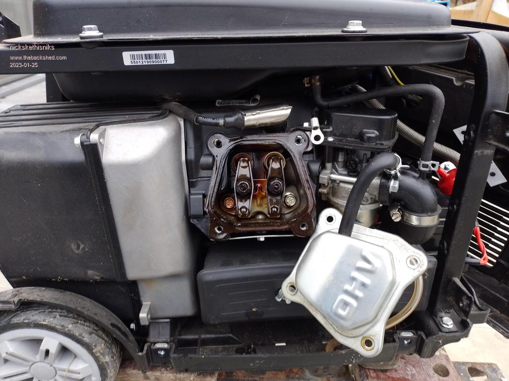

I think I feel the compression stage when trying the pull start, how could I inspect the open valve, just looking?
I will try to source that kind of spray, I saw that being used in some youtube video's.
Posts: 3412
Posted: 09:32pm 25 Jan 2023
"how could I inspect the open valve, just looking?"
With the rocker cover removed (photo 2) crank the engine. You should see the valve stems (inside the springs) move in and out.
While you are waiting for the spray try squirting a little petrol into the carburetor and see if that works. Even WD40 may work if it is almost firing, but just needs a little extra flammable vapor.

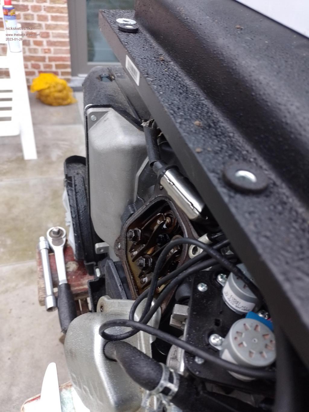

So I might found a problem, I checked the valves again during start up:
Something is stuck: sometimes it's normal but mostly not, so I assume one of the valves is not working correctly this way...
Can I assume this can be a major failure since it's not coming up?
I will try to upload a video.
Edit:
Ok, so I tried to move it a little bit by a soft hammer, but it's not moving fluently, I can move the small piston but it's going smoothly like the other one, the spring can't move the small piston by it's own.
What can/should I do next? Is it a lost cause?
Taking it all apart and then see further?
Edited 2023-01-26 19:28 by nickskethisniks

Looks like a stuck exhaust valve, usually they can get sticky and sometimes free up if wound over very fast with a fair bit of oil poured down the plug hole,  but a really stuck valve could be a different story.
A good soak in oil might help free it up, unless there is some other damage, hopefully the valve seat is not out of place, if it has an insert.

The engine looks like a Loncin Industries (China) version of a Honda.
As Revlac wrote if the valve stem is binding in the valve guide it can be freed up with some lubricant (eg WD40 or similar) and working the valve back and forth or rotating it. Easier to do if you remove the rocker but when re-assembling the clearance between the rocker and valve must be set the same as the other valve. You will need a feeler gauge to measure it.
If you can push the valve in but it doesn't return all the way, stopping abruptly 4 mm or more short then the valve seat insert has probably come out of the head. (Note 1)
Repair will require removing the head, getting it machined and a new seat insert fitted.
Note 1
Aluminium is too soft for a valve seat so a ring of cast iron or steel is inserted into the head.
If it comes out it drops and hangs on the valve stem, preventing the spring pulling the valve all the way back.
