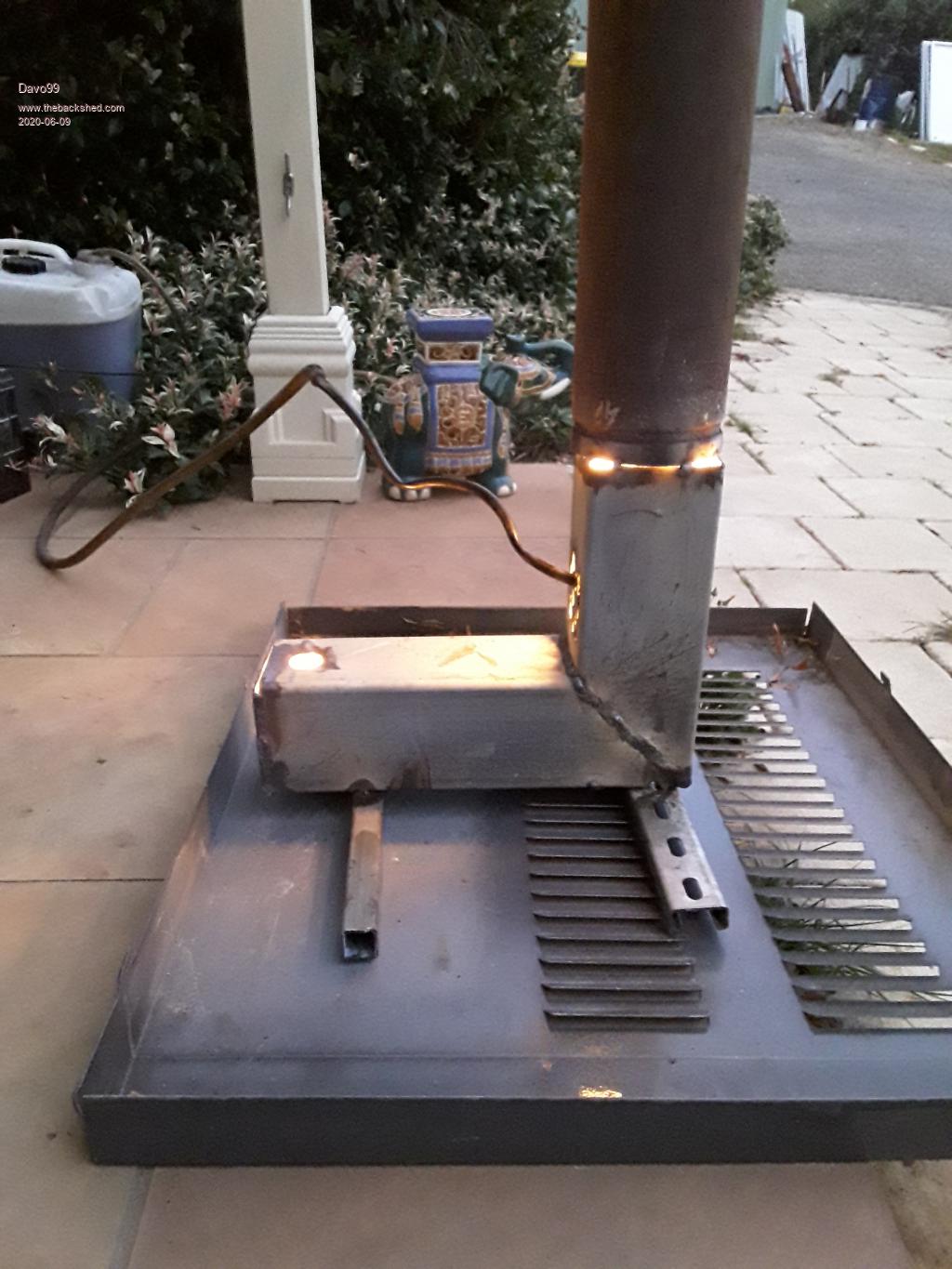

I was going through all the variations in my head and pulled out a note book I wrote my hair brained ideas in and re discovered my "L " Burner design.
This would be a draft type burner and I could pull the heat through the gas water heater as they have a flue/ HE right up the middle  which I could add to for more draft if needed.

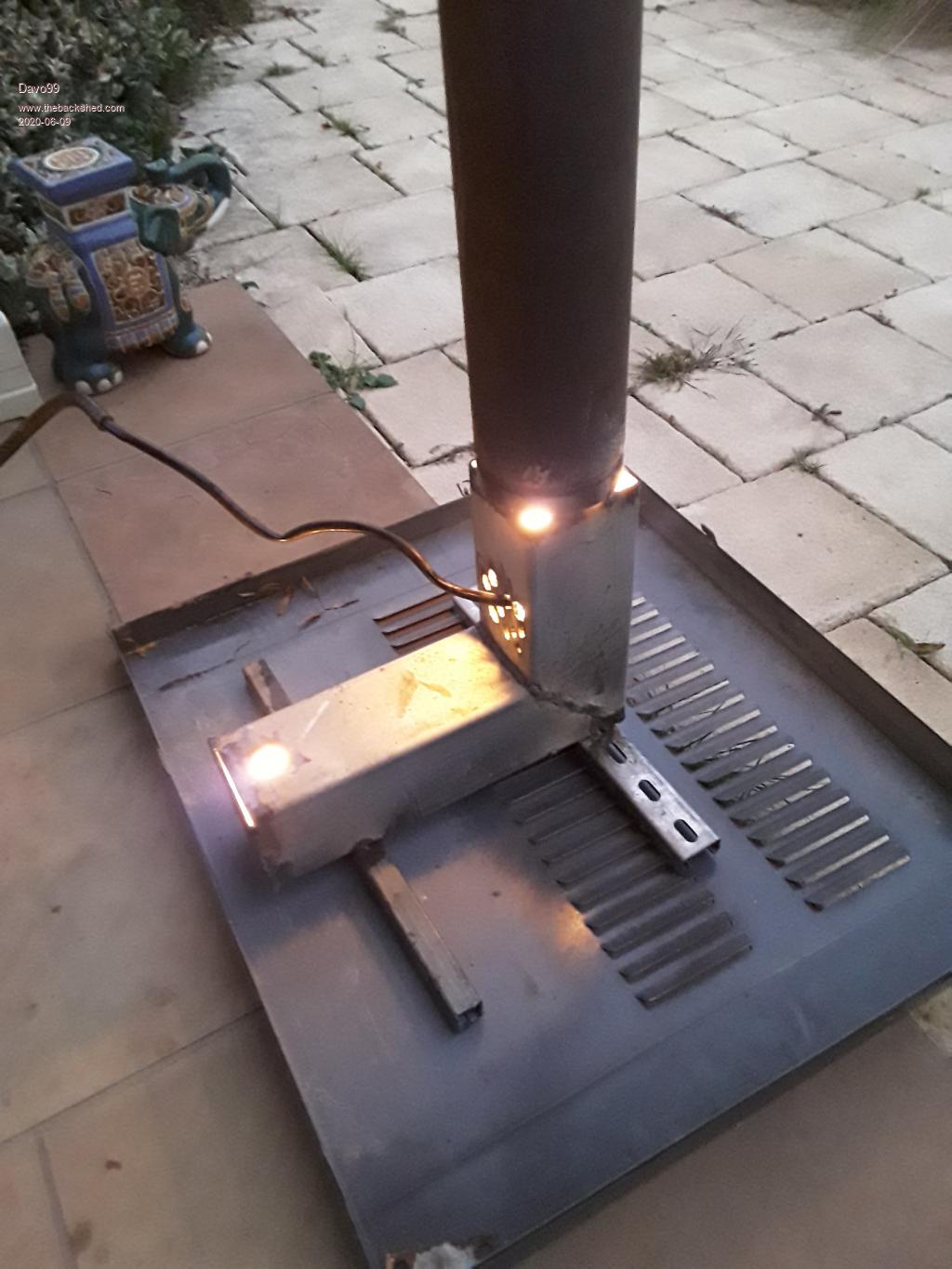

I have trouble getting things small in my mind so I got a bit of 75mm Sq Tube, cut a wedge out with the plasma cutter to bend it to a Right angle L shape and MIG'ed it back together closing off the open end on the horizontal Burner section.
There is a primary air hole in the top of the horizontal leg and cut some holes with the plasma in the upright section for secondary air.  Couple of wide legs for stability and a bit of 4" pipe about 1.5M long for a flue for testing purposes.   Very simple.
Put in a bit of oil and some diesel soaked paper towel, lit it and off it went no trouble. First thing is in this config it puts out a LOT more heat than 10 Kw. maybe something 30-40mm would do 10 Kw but that would be tiny and hard to imagine working at all. Concept would be the same so spose it would.
I can take the 3/4" Primary air hole down to about 1/2" which seems to be the sweet spot as it's set up now.  Running the thing flat out it roars, smokes a bit from lack of secondary air and glows red the first 45Cm up the flue. The heat radiated is very good for an outdoor heater.
I brought it down on the back verandah last night and set it up after the first burn and the thing throws good heat  for that application.  Mrs came out and had a look and then brought out the stew she made for dinner and we sat on the verandah and ate dinner by the fire.  Amazing how nice the most simple of pleasures can be.
This does roar a little but nothing like a force fed burner even on lw hear. If the chimney was fully ducted above the roof line, it would be very much quieter.
I'm feeding the thing with a Pulse pump because although everyone wants simple with gravity feed, it's more of a pain in the arse and inconsistent for long burns than what it is worth. Oil tank warms up and oil changes viscosity, level in tank drops, oil layers out....  You have to adjust the things constantly. Pulse pump, same volume every time and you can set the timing and it will do the same output all day.... or night. I'll put this on a simple timer or an arduino to pulse the pump for say a second every 15 or whatever seconds to get the output to as close to it as I want.
The output will change once I put the water heater on the thing as it has a smaller diameter through the middle and I expect cooling the output will also diminish the draft.  Might be good this is a bit over built.
I haven't measured the KW output on this but it can easily do 10kw and I suspect maybe 40-50. Definitely could do more with some extra secondary air holes and maybe a larger primary air inlet. If this was in a garage it would certainly put out good heat especial with a fan blowing on the back  to pull more heat from it by creating a greater temp Differential with the surrounding air.  The addition of something like an old 9 Kg gas Cylinder on top of the burner itself which I will look at for the verandah heater, would also increase surface area and more energy could be bled from it. I'll do a reverse internal flue for that so the heat is made to move around not just go straight up and out.

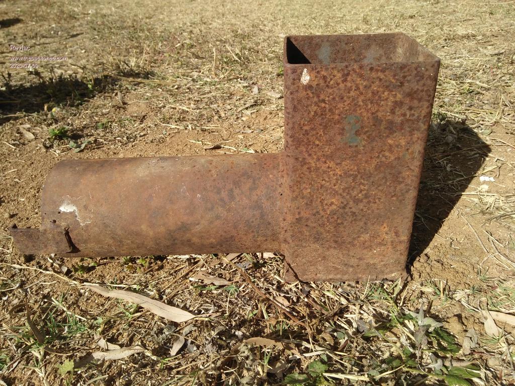

I did use some of those old type kero burners that had heating coils in front of the main jet, once they go hot and enough pressure was available they work really well.
Just thinking if the heating coils were used in the L shape burner it could draw a lot more air in and be quite ferocious.
I have made my own charcoal and gas for various things and use the charcoal in this little L shape contraption, it has a small grate inside and typically had a 12v fan at the front, easily melted down a heap of aluminium cans.
