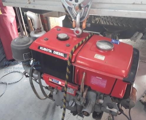

Hey guys, I scored a nice Kubota rk95 like here .
I want to marry it up with one or two F&P drives.
The motor will idle at around 750 rpm, the power at that speed is probably enough to run a single FP.

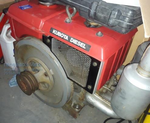

I have a pulley already fitted on the unit which is 110mm diameter.
I ordered a 180mm diameter pulley to go on the FP shaft.
So if the engine is running at 800 rpm then the FP will be doing 500 (I think)
Can anyone give some advice as to the best way to rewire it?
Might be an idea to mount it and see the voltage from one finger.
Currently have a 42 pole .8mm wire and a 36 pole .6mm wire
Edit, just found a 42 pole .6mm in the shed too.Edited by renewableMark 2018-08-14
