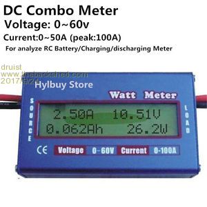

Am using this one
Posted: 02:02am 24 Sep 2017
That meter might be faulty or you have a open circuit somewhere.
Posted: 02:31am 24 Sep 2017
Do you have a multimeter that can measure 10 amps? If you put it across the solar panel output, you should see 5 or so amps. Disconnect the DC Combo meter first.
Or, grab a couple of 50 watt 12 volt light bulbs ( down lights or similar ), wire them in series and put them across the DC Combo meter output. The meter should read about 4 to 5 amps.

I love those meters. One big problem, they are self powered. Short it out and you have no power to run the meter electronics. These can be externally powered. There is a jack but they don't tell you the pins. It can be powered by a 9V battery if you don't want to read volts, just amps. Oh, and they only read current in one direction and only in the black leads. You don't have to connect through the red leads, just provide power.

thanks guys,yes have a multimeter will give that a go to rule this out. before i saw your replies went up to the panel and it read the same, the cheap charge controller read similar.
