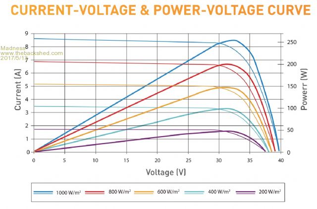

Posted: 01:25am 13 May 2017
This graph for some panels I have says volts stay the same at different light levels.

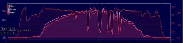

Posted: 04:39pm 14 May 2017
MPPT as the name says is tracking maximum power point, the graph below is from one of my Midnite Classic MPPT charge controllers. It operates at a lower voltage earlier in the day and late but during the day with clouds coming over there is little change in the volts.
Top red line is PV volts, other red line is PV amps, violet line is Amps out of the controller.
Edited by Madness 2017-05-16
isochronic
Joined: 21/01/2012
Posts: 689
Posted: 05:40pm 14 May 2017
What is the load (controller out) voltage, I am guessing 24 v ?
[nice chart too..]Edited by chronic 2017-05-16
Posted: 08:55pm 14 May 2017
It is 48V, there is a lot more information available but I made it simple for clarity.
isochronic
Joined: 21/01/2012
Posts: 689
Posted: 09:40pm 14 May 2017
Doh ! I was looking (squinting) at wrong scale ! (30 etc on left but that is current not volts, now I see volts scale is on right ).
