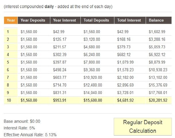

Francesca's financially frugal family that drops their on grid costs of $46 per week down to $16 per week and invests the $30 a week for ten years at a compounding 5% in a managed fund.
over ten years we are looking at this.
twenty grand! really? I mean $30 a week is the sort of money we could spend on takeaway coffee.

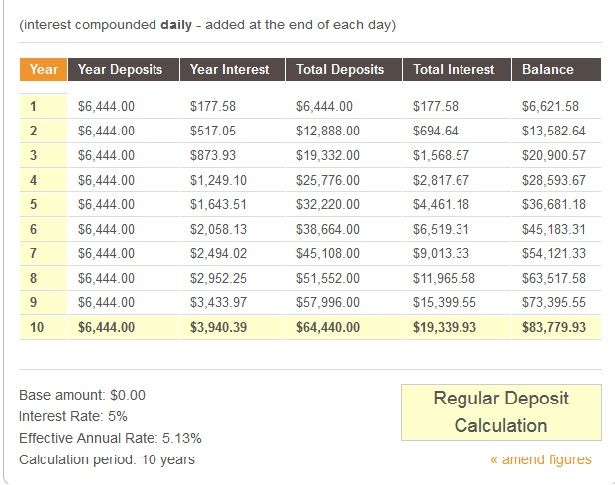

The average cheap family sedan probably costs $100-200 per week to own and operate.
So if we compare that to "norm's family" if we can get them down from $150 per week to $25 per week for electricity.
So, if we have a weekly cost or saving we could make, multiplying that amount by 670 will give the 10 years of compounding deposits @ 5% interest.
