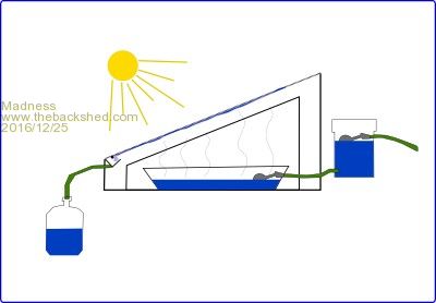

Another option is a solar still as shown below, water is condensed on the glass lid and runs into a plastic trough.

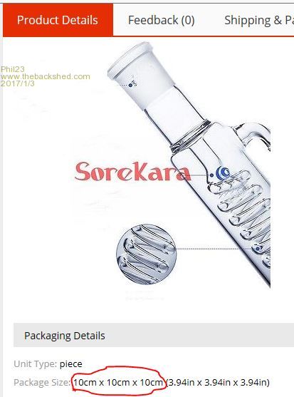

For less money than that I can get one of these Condensers but would it be suffcient?

The problem with solar stills will be the very low quantities and the high possibility of contamination because it takes forever to make any useful quantity.
Much better to build a really serious boiler and condenser, and make several litres at a time over a couple of hours.
Its fresh, its pure, and you know for sure there is nothing else in there.

Yes that would do the job but very slowly and being glass one slip up and there goes the whole shebang.

Posted: 12:12pm 25 Dec 2016
  Madness said   For less money than that I can get one of these Condensers but would it be suffcient?
There !
That is it, the real thing.
I thought they would be a more expensive than that.
I am going to get me a couple of those.

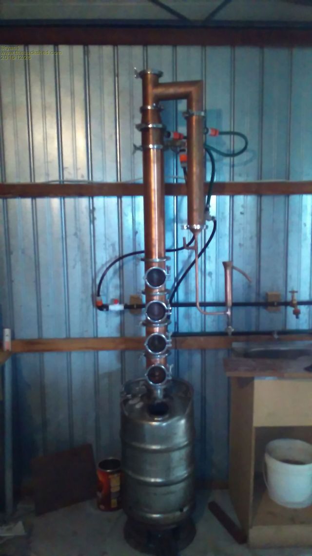

Yea I was tempted to put up a pic of my 2" SS pot still doing a Ouzo run, also good for making distilled water of course. But don't want to get in trouble so thought best to leave it

Posted: 06:18pm 25 Dec 2016
G'day Guy's,
Well not sure how long my deluxe water distilling appliance will stay up but here it is...
