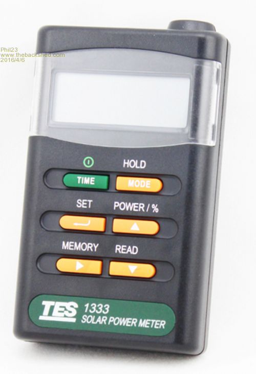

Recently bought a cheap Solar Irradiance Meter (Pyranometer), to play about with.
Have also been playing with measuring the energy with a garden light solar panel shorted with a 10 Ohm resistor.
Found it's fairly easy to set things to get 1000mV across the resistor when the Solar meter reads 1000 Watts/mē.
A simple calc of P=Vē/R x 10,000 will give me a reasonably rough estimation of watts per square metre from the solar cell.
The 1 volt output being read is an ideal level to me read into a Micro, & used in the logic of any solar based controller project.
PhilEdited by Phil23 2016-04-10
