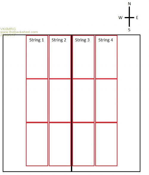

With the panels I have now are wired up in 3 series 2 parallel configuration, and when I get the extra panels it will be 3 series 4 parallel.
Hoping that this picture will help explain the final setup after the solar expansion.
At the moment I have only one string wired. Waiting on the last three panels to be delivered so I can setup and wire up the next string.
Once I have all 12 panels up on the roof they will be wired so the west facing strings will be in parallel with each other and the same with the east facing strings.
With the battery bank I was thinking that these would be enough for the foreseeable future.
http://www.aussiebatteries.com.au/off-grid-solar/battery-banks/48v-280ah-4x280ah-agm-deepcycle-battery-bank
These are the biggest (and Cheapest) that will fit into the cabinet the system is mounted in.
What are your thoughts on this? Am I over engineering this setup?

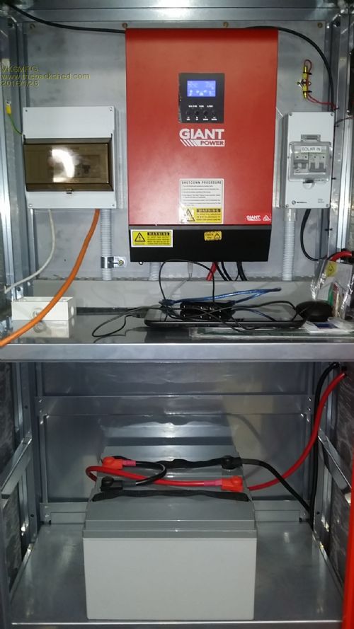

Posted: 10:48pm 25 Jan 2016

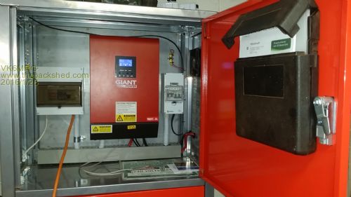

So this is the off grid system from Aussie batteries and solar. Details are at the start of this thread.
Here is a few photos of the current setup.
The other two batteries are on the bottom shelf just out of view.
Once I have installed a power point under the switchboard I will mount an old windows tablet PC to the front of the upper door for on-site monitoring.

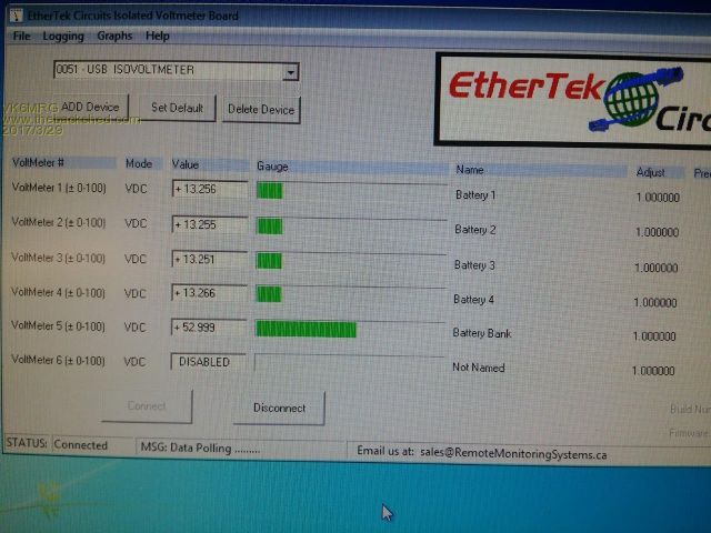

I'm still trying to work out how I can have web access to the monitoring software but i'm sure I'll work something out.

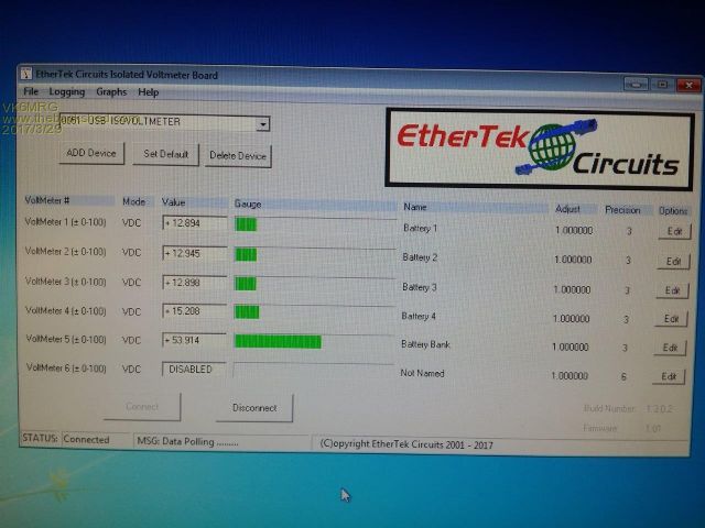

OK, I would like to upload my solar data from the inverter to PVoutput.org
Has anyone else done this?
And if so, what is required to do it?
I'm thinking that I'll need a PC or something running all the time and software to talk directly to the inverter or use the inverter software to save to a log file and import it to another program that talks to PVoutput.org
I don't really want to have a PC running 24/7. Maybe a Raspberry Pi or similar....
Any help would be appreciated.

davef
Joined: 14/05/2006
Posts: 499
Posted: 08:42am 27 Jan 2016
Do you have landline to your property?
I am using a FriendlyARM mini2440 running Linux with PHP5, WiFi and a small webserver. This unit talks to a cheap Samsung smartphone operating as a hotspot. Each day I send myself a log file using Google's SMTP server.
Currently, I am moving the "smarts" over to their new product a NanoPi. This board has WiFi built into it, so overall it is a cheap solution. And low current.
I have mains on all the time, so keep the phone charged from that and run the mini2440 off the 24V battery via switch-mode 5V buck inverter.
What format is the data in? Is it RS232, RJ45, USB or ? I assume you need to request the data from the inverter. I use Teensy USB boards to gather all my analogue and system status values.

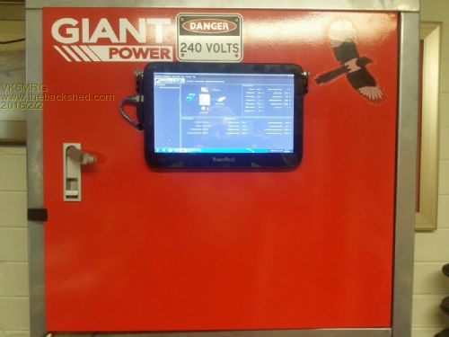

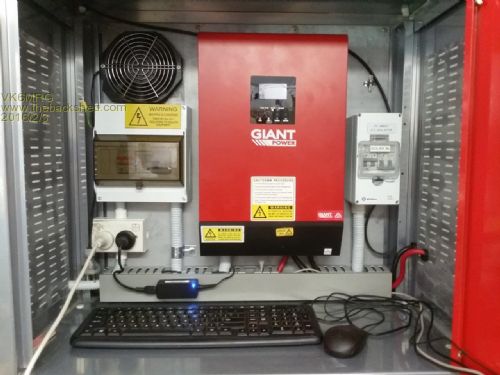

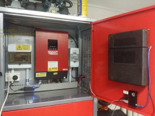

So I've mounted a GPO (General Purpose Outlet or power point) under the switch board, removed the cooling fan from the side of the enclosure (as it had very poor air flow caused by the slots on the side of the enclosure that it was mounted to), Turned the internal cooling fans over so that cool air blows up inside of the inverter and mounted my tablet PC to the front top door.
I will remount the cooling fan along the side of the IPS so that it sucks the hotter air out from the top of the unit to assist the two internal cooling fans.
My old windows 7 tablet PC (with cracked screen) mounted on the door for easy access when required. I have mounted a USB hub to the back of the door for a mouse and keyboard as the touch screen no longer works. I want to find and mount a fold-up shelf for the mouse and keyboard so they can be out of the way when not in use.
I think that is it for the moment.
Just a little update to show that the system is getting closer to being ready to install in the shed. Edited by VK6MRG 2016-02-03

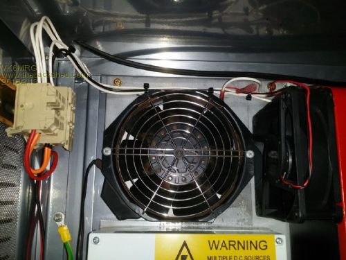

So I've mounted a 240 Volt AC cooling fan to the top of the enclosure for when the system gets above 50 degrees C. This will be switched via a 48 Volt contactor in the switchboard. I just need to get the contactor and wire it up.
I'm also looking at mounting an external fan on the side of the inverter to assist the internal fans.
I may use an external fan speed controller that I made a few years ago so that the fan will alter it's speed with a rise in temperature, and when it's cool enough will shut down.

I have mounted the cooling fan to the side of the IPS and added the 48V wiring ready for the contactor when it arrives next week.
Another step closer.....
Just an extra note. I forgot to mention that I have installed TeamViewer to my tablet PC to give me remote access to the PC and the remote monitoring software for the IPS and Battery Monitor logging software.
I also have it installed on my office PC and my Android tablet and it all works very well.Edited by VK6MRG 2016-02-14

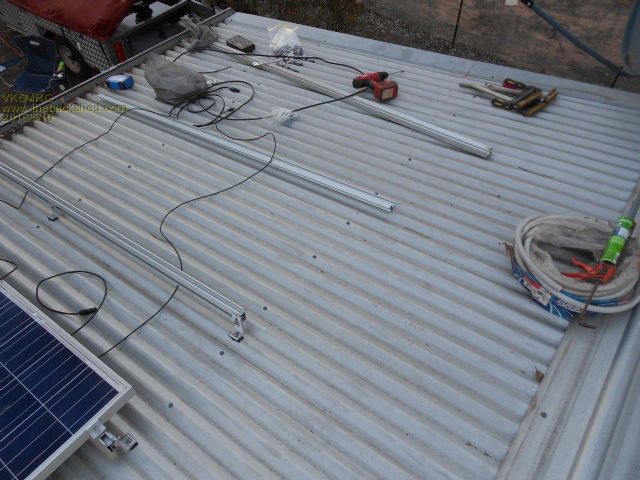

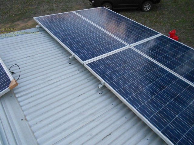

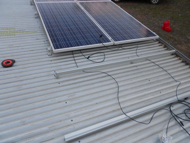

Posted: 08:38pm 14 May 2016

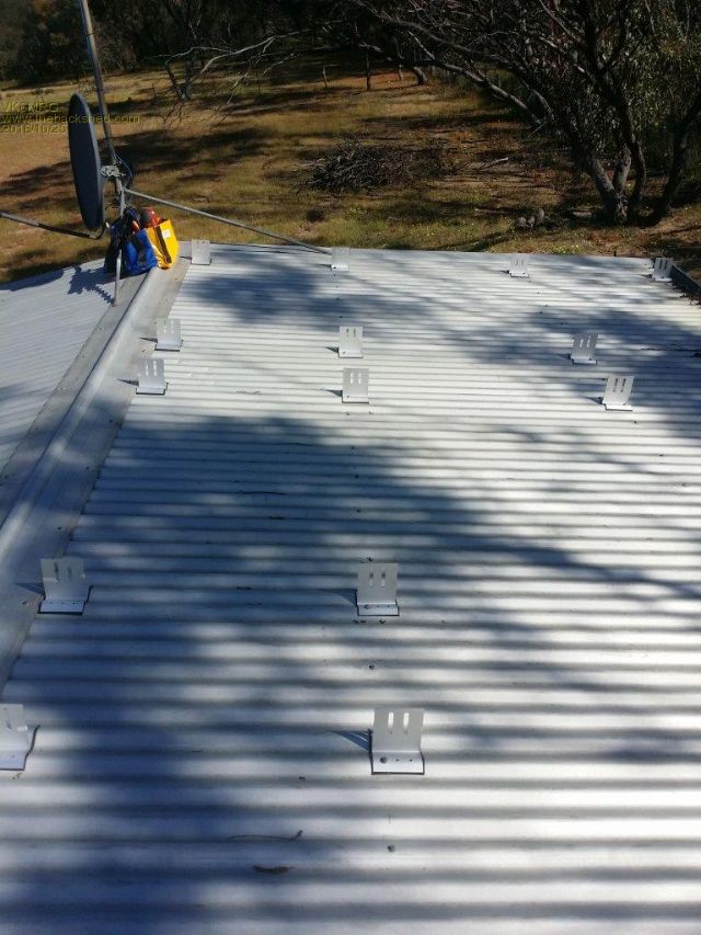

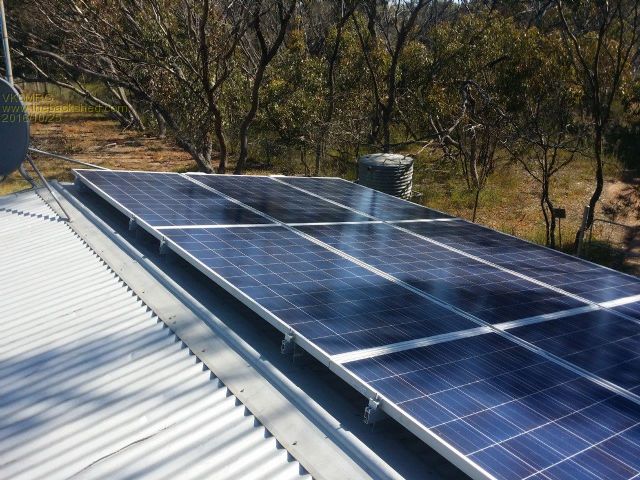

So, I have installed the system into the shed on my bush block. I will ad the few photos that I have taken .
At the moment I have 6 300 watt suntech panels which are east facing and later in the year I will add another 6 300 watt panels on the west facing side of the roof.
I have a ceiling fan, lights and a fridge in the shed and the system runs these loads with ease. Also enough capacity to run a vacuum cleaner or a kettle or even a small toaster oven.
As expected the capacity of the battery bank is very limiting, however this will be rectified later in the year with the purchase of larger batteries.
Overall I'm am very happy with the system.

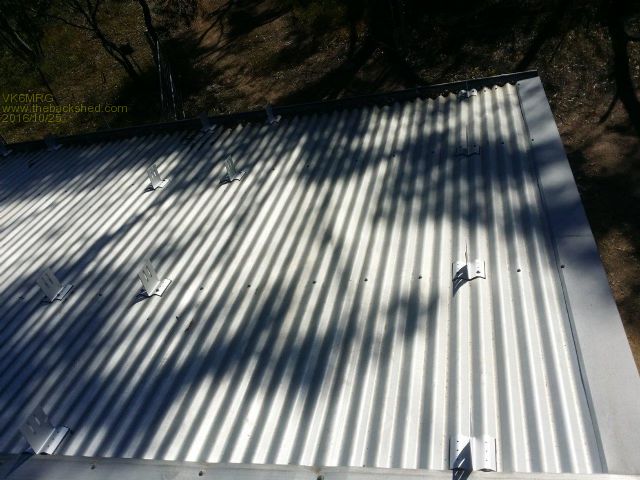

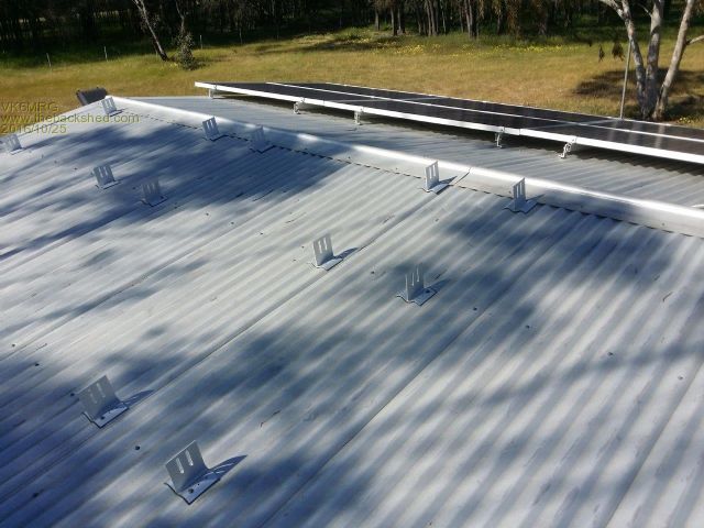

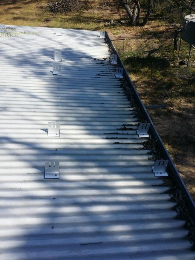

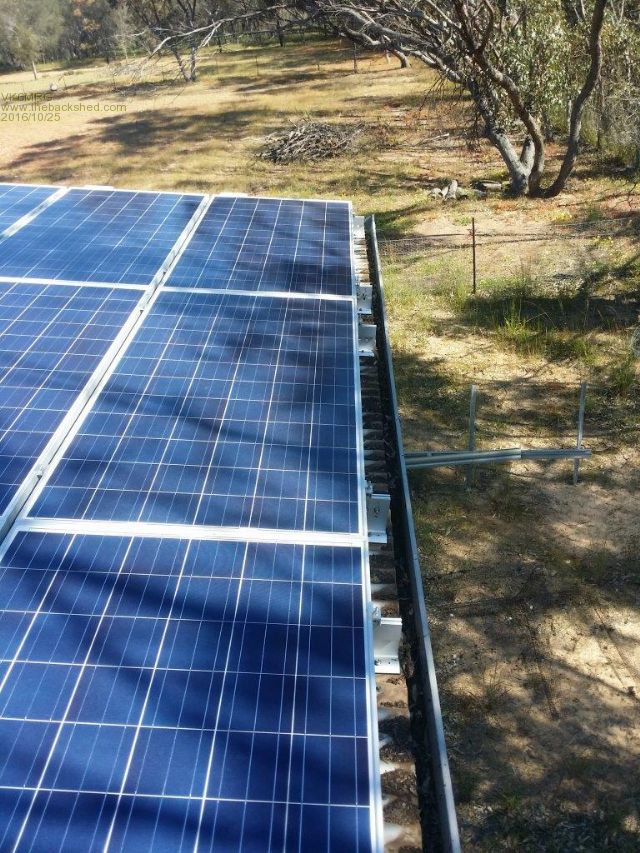

Posted: 09:33pm 14 May 2016
I have just ordered 2 Midnite Classic charge controllers as they only need a shunt and 1 inexpensive device called a Whizbang to give full remote monitoring and data logging. The software is free as is the online data logging, so you can easily see and program settings remotely. Also gives state of charge, another benefit is ground and arc fault protection is built in.
KarlJ
Joined: 19/05/2008
Posts: 1178

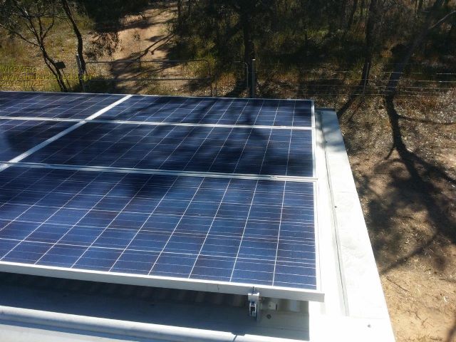

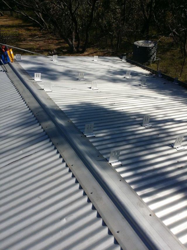

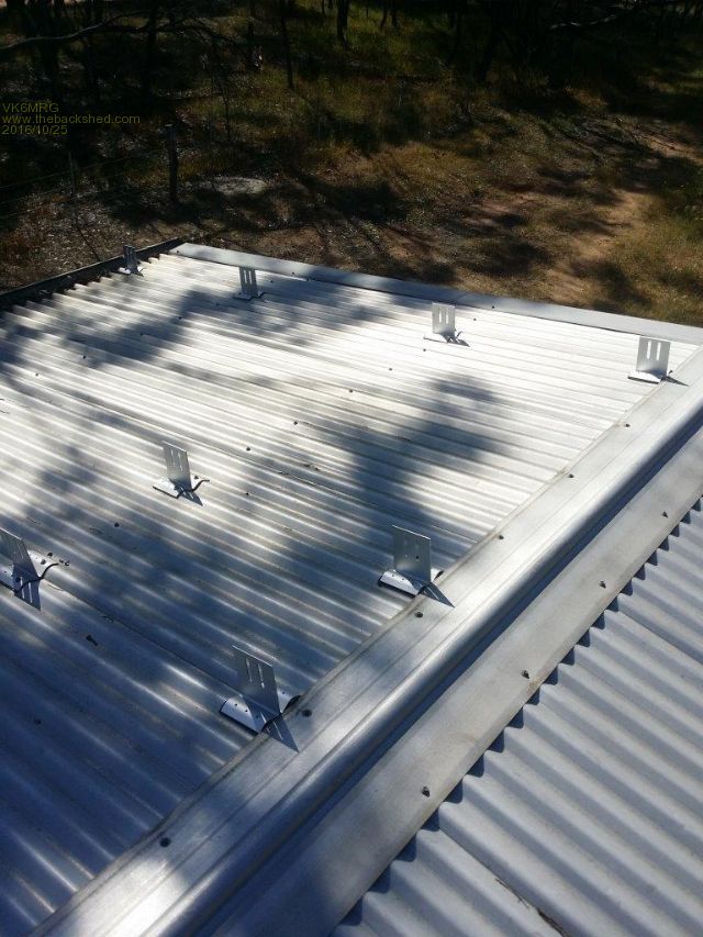

Posted: 01:27am 15 May 2016
watch the clamping zones on the panels
ie you're outside the recommended.
AS1170.2 requires clamps min 200mm from the edges of the roof = yours a fail.
Dont run them in string of 3 as they will run at 75V+ in the sun = charge controller fails everything goes up in smoke
perfectly OK to run them in pairs instead and Buck converter in the Charge controller needs to do less work = less use for the poorly vented enclosure and giant fan to band-aid that.
Pity i missed your thread - the Victron gear costs peanuts more, Lithum would be 10x the cycle life of the batts you got.
Keen to see how many "giants" you break in the coming couple of years.
