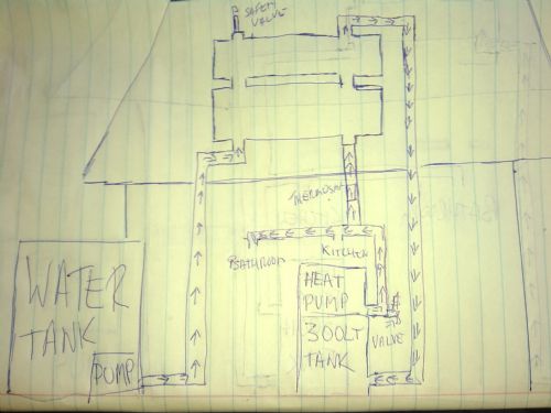

i tried to load an image of my design what i thought is house water tank to solar hot water panels to in let of heat pump which has 300 litre tank and a safety valve than outlet hot water to kitchen bathroom then onto inlet to solar hot water panels,thinking bout having thermostat connected there do when 300lt tank get too hot pushes water back to panels,the hot water panels also have release valve at high point ,just wondering if i need a circulation pump or if will push its self around....Howly

The plumbing arrangement should look more like this -
See the hot water leaves the panels at the top and returns the water 1/2 way up the storage tank. The cold water from the tank goes up to the bottom of the solar collector via a small pump.
