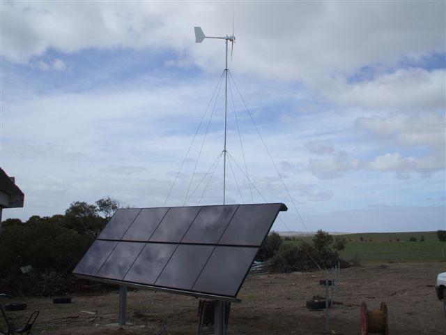

here are 10 modules installed at a coastal site near Elliston SA 3.5 kWh/day from solar.The wind is always
blowing there and 4kWh/day plus from the wind turbine is quite common in fact the wind tends to shut down the solar system with "battery full" showing on the screen of the MX60.
