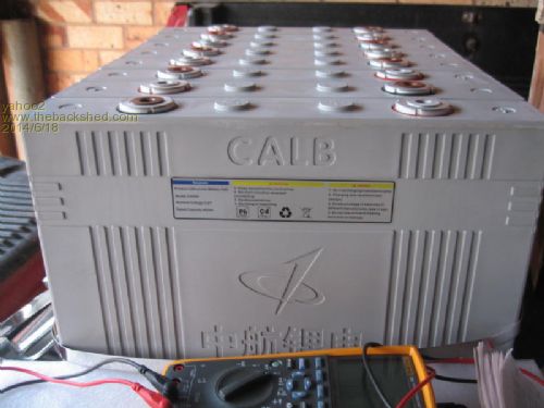

Its a 24volt 400Ah bank. This photo is just before I fired up the banding tool and clamped the cells together.
The cell voltages averaged 3.2908 volts out of the box with the highest at 3.2933V and the lowest 3.2889V. I couldn't make a decision about how to charge and balance them before I get to the installation stage. I thought they were close enough that I didn't need to wire them parallel for an initial balance before I started.

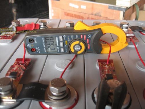

With each half of the pack getting close to 14.4 volts, four of the cell modules triggered at 3.6 volts and started to balance those cells.
This one bypassed the most at 0.6 amps for about 10 minutes. the others were less than 0.2 amps for less than 5 minutes. A bit of an anticlimax in the end, I was expecting to have to work a bit harder than that.

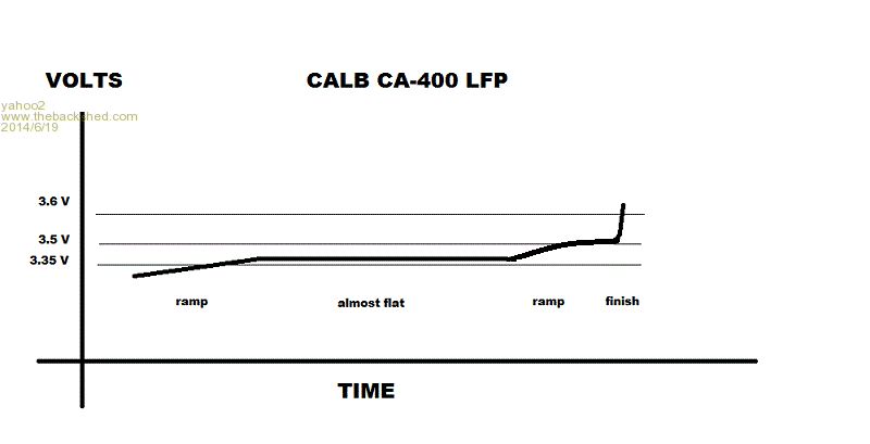

One thing I noticed while charging is the curve has two distinct ramps and two sections that are almost flat.
At one point one of my multimeters was not capable of measuring the cell voltage rise, the other one was ticking over at one ten thousandths of a volt every two and a half minutes, that is almost billiard table flat. The voltage rise is very rapid at the finish, even with the tiny chargers hooked up it was going up at one mV every 2 seconds.
This looks to be a distinctive characteristic of charging the CALB cells at less than 25% of their capacity.

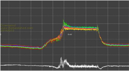

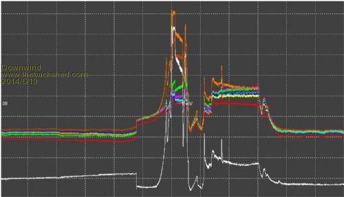

Recording a pack voltage only tells a small part of the overall view, i would say almost useless information,
To log and plot each cell will be a tell all of what the pack is doing.
You have some dinky device on each cell to control the max voltage, Is it actuactually doing what you expect it to do, or is it doing what it wants to do.
Untill you log each cell then its pointless in posting pack voltage curves, they tell nothing, as the important part is when the cells reach full charge (in the mV range)and how the cell controllers work at that point.
Lets look at a log plot of the equalizer off for a period in the day.
As you can see how far each cell (coloured line) becomes seperated from each other.
Then we look at a day with the equalizers on and how each cell follows the other.
As you can see there is a big difference to each cell, and its up in the Mv range and not down in the general bulk charge range that matters.
Pete

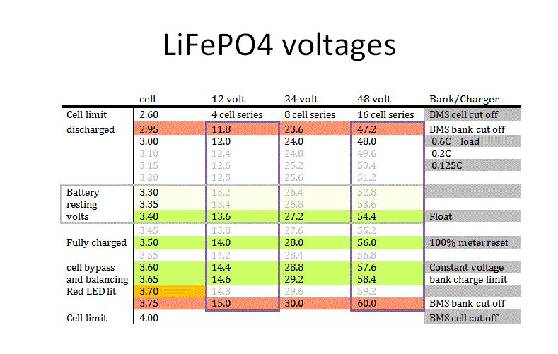

I'm getting tired of recalculating voltages all the time so I have done up a cheat sheet as a quick reference for myself.

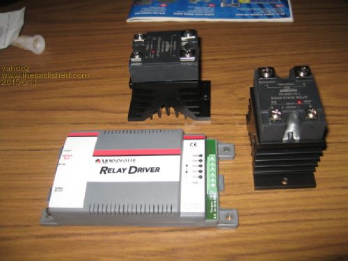

I purchased a high power schottky diode pair with a common cathode and put that in series with the positive lead to the LYP battery bank.
Each diode is normally shorted out by the contacts of a latching relay (mine have 80A contacts). The latching relay are operated by the BMS, one opens at over voltage and the other at under voltage.
The diodes ensure that if, say, under voltage trips, charge can still flow into the bank but nothing out until the bank voltage has risen sufficiently.

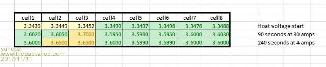

There is no detectable imbalance between the cells, at least not with my old multimeter, after 50-something cycles and no balancing.
I am still amazed at the way they charge. If there is any capacity left to fill, it is just wide open throttle until the last few minutes, even though the absorption phase light has been flashing for an hour. After spending so much time watching lead acid batteries meandering towards full charge, I feel like I will never get used to that.

How old is your multimeter? does it read down to mV differences?
On my LFP there was no cell difference (<10mV) during most of the cycle.
Only at the top of the equalising period did the cells differ by up to 150mV, strangely the two cells closest to the connection of the charging cable always having the highest potential.
I did not realise this until I started logging the individual cell voltages during a 24 hour cycle.
I have now added adjustable 4A shunt regulators, they had hot heat sinks on the first equalising cycle after fitting them. After that all heat sinks are always at the same ambient temperature and the logging graph shows all cell equalise to within 10-15mV of each other.
