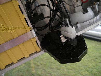

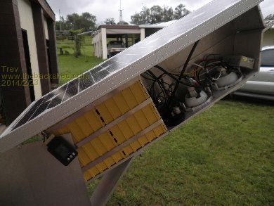

One of the commercial batch of Relativities is tested on my Solar Light.

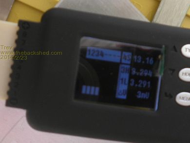

This light has a 40ah Winston LYP 12v battery. It has been running now since late last year on a prototype Relativities keeping the battery cell voltages in balance. Last week I fitted a Relativities from the commercial batch.
I have seen the cell voltage difference as high as 14mv, but just now I get some pictures and the cell voltages are showing only 3mv difference. Relativities has been in the pipeline a long time to get to this point. It is very exciting to see it work.
