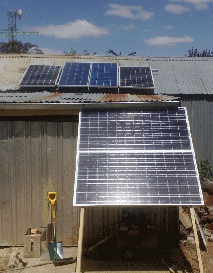

200W x 12V Solar Panels (X4)(All 4 are same brand and same age)
120W x 12V Solar Panels (X4)(2 are 2yr old and 2 are 1yr old - Same Brand)

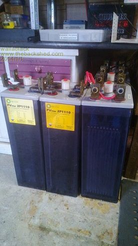

12V Battery Bank @ 798AH consisting of 6 x 2V 798AH (@ 25hr rate) BP Solar 2P1110 Lead Acid Batteries.

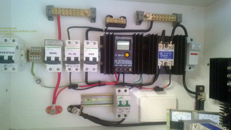

Here is a quick schematic which I think is “semi right” but some things may need altering…I will get to a few questions later.
The wire size is indicated in the drawing and I have left it as simple as thin lines are smaller wiring (of differing gauge) and thick lines are large wiring (of differing gauge), obviously red = positive and black = negative.
Large rectangular blue boxes are breakers and small rectangular blue boxes with an X through them are fuses...except the NT 1 3 way fuse holder which is the first protection from the solar array.

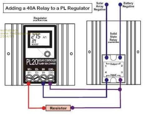

And here is a Plasmatronics schematic for the additional SSR. I am led to believe that this was a schematic drawn up by the good people at RPC (Rainbow Power Company).

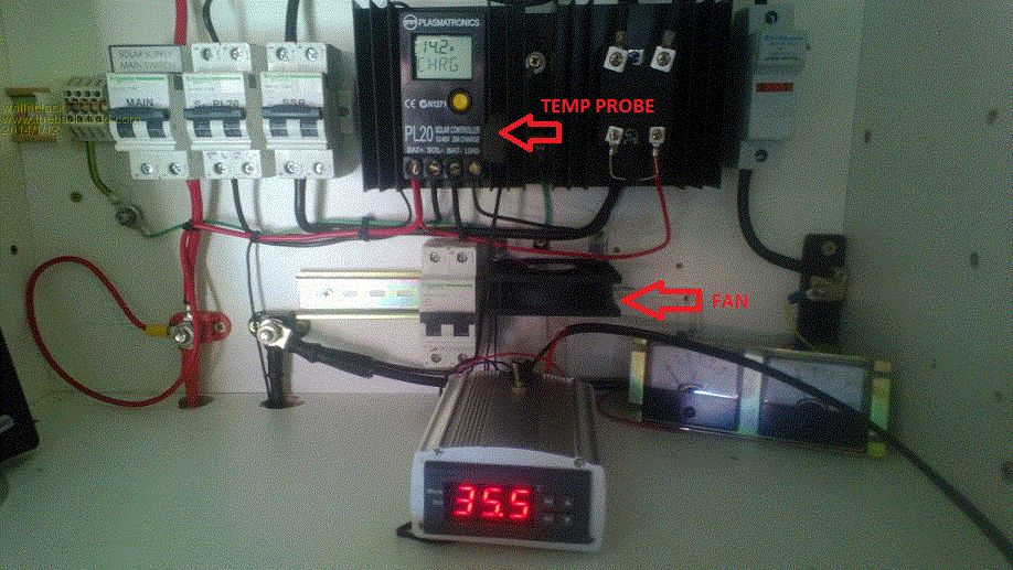

I want to run a small 12v fan to cool the SSR but trials that I have done with any fan prove that most 12V fans cannot handle 13/14V plus volts for very long and live a short life. I was thinking of putting a resistor on the positive lead of the fan. The fan I want to use is a 12V 0.20A. I would intend on connecting the fan as desired as when it gets hot here, it gets hot. The PL20’s heat sink was really hot the other day when it was 45 degrees so every little bit of help in cooling would be beneficial, and let’s face it, in that sort of sun a .2A voltage loss is no great drama.

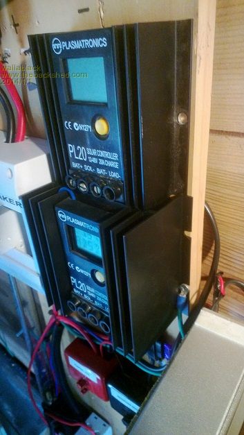

On the heat side of things I have actually modified one of the PL20’s to mount to a much bigger heat sink to help this situation. You can see the difference in heat sinks in the below picture.

The “Catch Diode” that connects to the SSR is a 1N5404. Plasmatronics/RPC (Rainbow Power Company) literature to add the SSR say, Quote “catch protection diode should be placed across the output of the solid state relay (band of catch diode to the battery negative side” Unquote. With most other callings for a catch diode with Plasmatronics PL20 applications it calls for the band to go to the positive side…..Is someone able to clarify this for me?
8.
The same literature states, Quote “Extra connected solar arrays will need reverse blocking diodes (unless the SSR relay uses a reverse blocking design)” Unquote. Obviously the SSR has all of the extra solar connected to it but it is only the negative of the solar. Do I need to put the diode in this line? Every time I have used a stud diode it has been in the positive line.
9.

3) See #2. What does the 220 Ohm resistor do? If the control fuse to the PL20 (Batt +) blows then the SSR stops working, is that OK?

6) Kinda surprised that a nominal 12V fan can't handle 13 to 14Volts. Our equipment was rated to 16Volts and I don't recall fan failure attributed to over-voltage. Will a 24V fan work at 12V?

8) As far as I am aware all modern solar panels have reverse blocking diodes in them. Maybe, try an ohmmeter check?

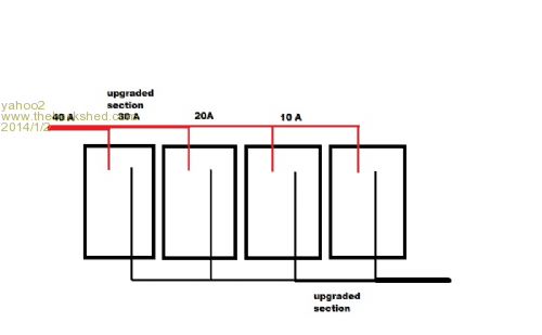

Looks like you are pretty much all over it design wise. Panel to battery bank ratio is right at the charge limit so you couldn't have planned it any better. Keeping the number of connections exposed to potential high amp loads is also excellent.
Only thing I would suggest is to think about the solar panel wiring. If you wire both the positive and negative out one end there is a large difference in wire length between panel 1 and panel 4 using a two into one pv connector and daisy chaining them, and there will be sections of wiring over the practical current limit on the 60 amp bank.
The last 12 volt system I upgraded with extra panel banks with an eye to converting to 24 volt in the future I linked the positives out one end and the negative out the other (to keep the wire length the same to each panel)then fitted a heavier gauge wire in the connectors on the sections that take the full bank load. It seems to work OK and I can change to 24 volt in a few minutes with the existing wiring and connectors.
Fault finding solar panel wiring on an old crusty flat mounted system on a sloping roof is one of my all time least favorite jobs, specially when the bolts on the clamps are all rusted solid.

This is roughly what I am talking about.

3. I would prefer the SSR stop working than the PL20 or anything else gets damaged. In my eyes if Plasmatronics suggest it, I will follow it.

6. I have gone through a few fans at 12V….maybe 5 – 8, even one from a used 28V – 55V chinese GTI. Might be work investing in some good quality 12V fans with good bearings etc, on my research they more expensive ones actually use less current too so that’s another bonus.

8. The diodes are Schottky diodes for protection which are completely different to reverse protection diodes. Am I correct?
  yahoo2 said   Looks like you are pretty much all over it design wise. Panel to battery bank ratio is right at the charge limit so you couldn't have planned it any better. Keeping the number of connections exposed to potential high amp loads is also excellent.

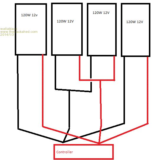

The panel to control wiring is my confusing bit.
Just an insight.
Wher the control board will be located is directly below where the solar panels are mounted so the distance from say the CENTRE solar panel on the array is probably no more than 2 metres away from the control board.
I really want to bring each solar panels + and – directly to the control board so I can have more control (actually more tinkering). Figuring that the farthest panel from the control board will be say 5 metres.

VERY good food for thought. As I mentioned above relating to distances the cable will make quite a difference.
  yahoo2 said   This is roughly what I am talking about.
Nice idea….

Well I have made a little bit of progress...I love holidays!
Question: Am I killing it with the use of only one side of the circuit breaker? These are what I had available to me. IMO I can't see a problem with it but I am no solar installer...I dig dirt for a living...big difference.
Ignore the right hand side of the pic, this is 2 rectifiers, another SSR and another PL20 for my wind install which I am all over and it has been in operation...this is just it's new home.
I think I have put the shunt in the right spot to measure the SSR output...I think. The two analogue V and A meter were from a 24V wind charge controller, this will be upgraded when I get to town one day...
The SSR I have installed there is just a cheaper one, once I have run it all for a while I will put the good one in.

Quick question.....
I live in an area with very high sunlight.
I have been testing a PAIR of my new Rich Solar 200W 12V panels...
Individually they reach 10A
Together they do not get over 12-14A.
Simply joining + to + and - to - and testing them at the end of the 800mm lead from the panel.
I would understand if it was slightly overcast weather but we are getting some top notch sun today.
And another observation (or mistake) in regards to completely different panels....
With the above diagram originally installed to two separate charge controllers and then to one charge controller....
All combined I was only getting peak of 25A.
Connected with 6mm^2 cable and the controller only 3 metres from where the array was mounted. Peak was most of the afternoon but even when the sun was 90 degrees to the panel and on a 40 degree perfect day it only got to 25A.....
Thinking of it now am I right in saying the panels are 120W x 4 = 480W, batteries are at say for example 13.8V. So 480W / 13.8V = 34.8A......only getting 25A so 13.8V x 25A = 345W in perfect conditions.Edited by wallablack 2014-01-04
Foolproof systems do not take into account the ingenuity of fools.

Heat reduces the power output, the cooler your panels the better they work. Today I was not getting over 2300 watts, rated power is 2840. I have seen it go over 3000 after being shaded by a cloud for a while then getting full sun. Still made 17.9 KWH's today.
Saw a thing in Jaycar catalogue this morning where someone said putting a spray of water on the panels increases the output. I tried it for a while but did not see it change much, maybe I was not persistent enough.

  Madness said   Heat reduces the power output, the cooler your panels the better they work. Today I was not getting over 2300 watts, rated power is 2840. I have seen it go over 3000 after being shaded by a cloud for a while then getting full sun. Still made 17.9 KWH's today.
I did the same thing last summer. I put a sprinker on the roof of my shed to keep it cool and it was coincidentally wetting the panels too. There was a 2A rise in output but noting major.
I have a 10,000lt tank for the rain water off my shed roof so I recirculated it from that so the water was cool all day long...BUT, do you think the constant water coverage would somehow "shade" the sunlight and have a reverse affect...would be better cooled from the underside with a sprayer etc. Even during the heat/peak of the day I give the panels a good spray/cool and notice a rise in amps.

Are you getting resistance as the batteries charge dragging the amps down? Really need a good consistent load added to test things properly.
normally at full load the panels will output close to max amps, the 20-25% loss should be in voltage difference between the panels max output volts and the battery volts.
Best thing to do is download the panel output graphs and do the calculations from that.
Most of the panels I have installed output3%+ more than their advertised output, due to improved manufacturing and a lack of the lower solar cell grades so sometimes I have struggled to get under the controllers limits but it does make up for some of these voltage "headroom" losses you need with WLA batteries.

  yahoo2 said   Are you getting resistance as the batteries charge dragging the amps down? Really need a good consistent load added to test things properly.
They were solely connected to the battery bank, via controller of course...problem was is were I was testing them...DAAA!!!
See the guttering is shading a portion of the top panel.....funny how things are easily overlooked. Guess what, I moved them lower and they are really good lol...Good time to test my under panel spray cooling but I'm not because I would like the water recirculated....it's the eco warrior in me.

I must admit I don't see the point of tweaking those last few watts out of an off-grid system (with water cooling).
the panels only run at full power for a few hours, most days they sit idle for most of the afternoon just topping up the batteries.
It is winter where an oversized SSR panel bank really shines, no need for cooling then. Having a solar heater tank full of hot water and batteries well on the way to full charge with the dishwasher or washing machine going in the early afternoon on a sunny winters day never gets old in my book.
