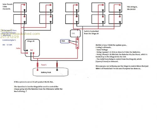

Ok.. here goes..
So If I'm correct I should be able to do this..
Has anyone done so..?

Now your talking, using relays so as the Dingo can handle more then 20 amps solar. But then I`m reading a very fuzzy diagram.
Plasmatronics manuals are tops you`ll get all you need from them, just a matter of getting your head round them. I assume from your diagram that is what you`ve done.
Now you can look to the load side of things you`ll find the Dingo will do that ensuring your battery does not get drained too low, once again using relays if your load is in excess of 20amps.
Would suggest if you wish to also charge from your vehicles alternator you wire it through a manual switched relay direct to your battery. The Dingo will sense your batteries charge and control the solar input. The KISS principle, for reliability.Edited by norcold 2013-12-30

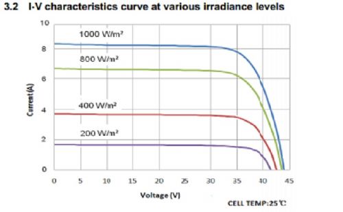

the error in your logic is that you are looking at the panel voltage and assuming that the controller will convert all this energy to usable power.
if you are not using a mppt controller that can step down the higher voltage (like the midnight solar classic)then any voltage that is beyond the battery voltage at the time is technically a loss.
for example
with a 12 volt system and grid spec 72 cell panels 45 volt open circuit 35 volt max power 8 amps short circuit at 1000w/m2 (sunshine)
The graph shows a fairly flat amps curve so the amps output from the panel only changes with the amount of light that is hitting the panel.
Here is the tricky bit, max watts will be at the point that the controller starts to pulse modulate the solar input. so if the end point for LFP's is set at 14.3 volts then,
14.3v x 8A = 114 watts from a 280 watt panel. if the cost of the panel and fittings was less than two 12 volt 70 watt panels it might be viable but it would only work with a plasmatronic controller, most other controllers have a lot tighter limits on the max panel volts for different battery voltage ranges.
