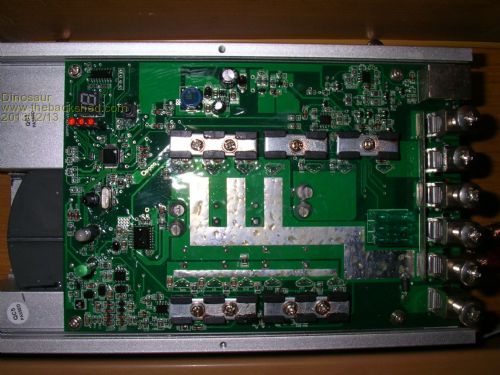

I am trying to find out if I can use the Tracer to shut down the battery charging
from a remote source.
IE: 8 cell monitor has a N/C alarm output that I would like to use to simulate
a fault condition that shuts down the Tracer.
Others have fitted SSR's with massive heatsinks, which I would like to avoid.
Have emailed Tracer, but dont hold much hope. There are no external connections
for such a purpose, but perhaps by connecting directly to the board ???
Anyone have any ideas on this ??

Trying to get a schematic out of Tracer or the supplier, who seemed to repair these devices, proved to be fruitless.
I am not familiar with LifePo4 cells, but would expect the charging regime is different than Lead-acid/SLA. Which would mean re-programming the "smarts".
Has that model got a RJ45 connector on it?
I even tried to get some insight to what was inside the remote on/off switch option, so that I could interface my own switch contacts. I suspect that a simple switch connected to the RJ45 connector would do the job, but was not prepared to open the box until the warranty runs out.

I am not aware of this option. There is a SW 1 header on the main board, which I suspected may aid my cause, but sofar no reply from Tracer.
Just below the led's there is a unpopulated 3 pad SW 1 item.
Really, a remote On/Off switch is all I need.
