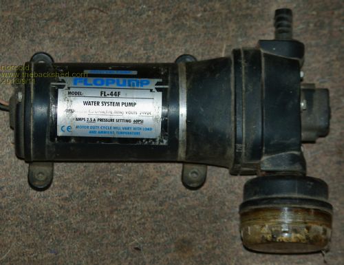

David,
My Lorentz ceased up when it was about 2 years old, on taking out of the bore and separating the "screw" from the motor found the motor was hard to turn. My supplier checked it and told me that a batch were sent out that had bushes(bearings) that grew tighter with age. My pump was one of that batch and Lorentz repaired it free of charge.
The diaphragm pumps I am talking about are the 12 or 24volt DC variety, that are used frequently by farmers up my way to spray weed control from usually 4 wheelers with a small tank mounted on back.. They have no solenoid just an eccentric driven bearing on the shaft of a normal brushed motor. Similar to a wobble plate, usually having 4 diaphragms. The expensive ones are stamped Made in USA (Shurflow etc), but I suspect they are in fact made in the same place as the Ebay ones, China. I wrap 1/2" copper around the motor and feed the discharge through this,for cooling, they then will run continuous.

Posted: 09:09pm 10 Sep 2013
David,
This is a single ended one.

Hi Vic,
Thanks. I should have cottoned to that. We'll blame IWT for the memory lapse.
I have one of those little pumps on a "garden" boom spray I made up to tow behind the ride-on mower for broadleaf control in the couple of acres of "lawn" we have. I usually use methyl chloro phenoxy acetic acid.
I'll have a look at the head/flow specs. The unit I have has a built in pressure switch. Perhaps I could use one to boost the hot water which a header tank type in the ceiling and doesn't have nearly as much pressure as the cold water which is gravity fed from a tank on the hill about 250 metres behind the house. Not sure how it would go handling the temperature though. More thought required.

David,
Feel they`d probably handle the hot water, the diaphragm`s appear to be made of a silicon like substance rather then rubber. They have inbuilt thermal protection in the motor, some have fan cooling(although the ebay ones I`ve purchased so far haven`t). They have proven to be fairly bulletproof.
