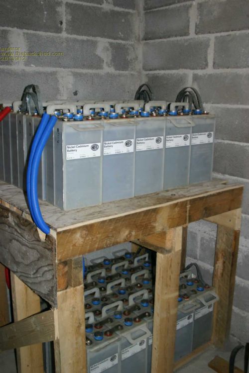

Here you can see half of my batteries.
They say NIFE but they are NICAD batteries.
NIFE is the brand of manufacturer, which is nowadays SAFT batteries.
