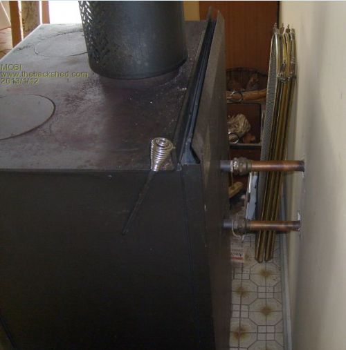

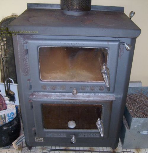

I thought I'd put up a couple of pictures of the wet back heater we have. As you can see, it has a generous cook top and an oven which is great for baked dinners and making cakes. A bit tricky for bread though.
The wet back system is open loop to the header tank in the ceiling through 1" copper pipe up the wall cavity.
No, it doesn't have a slope, Ilean.
