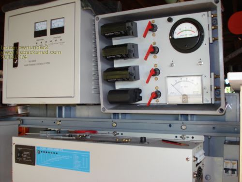

Hi Lapsy,, Yes, I'm sure there are handy people in our crowd that have done their own solar systems .. If they are connected to the grid ,,I bet you won't get them to admit .
Make your own solar system "bit by bit" --sure , why not . I see brand new panels are less than $1 per watt now on e-bay . I got 4X 220 watters for $770.
The grid-tied inverter, look on e-bay , saw them around $200 for 1Kw last week,( people are up-grading ), so the smaller units are out there cheap.
Renters---- thats a sorry note for you guys. you see, you only rent the space in that unit or house, you really can't attach or drill holes ,Etc ,unless the landlord approves. And I think the landlord is the one who has to do the paperwork to the electric company .
Portable ,, I see lots of those folding small panels on e-bay ,,just for camping ,Etc.
Switches, I use those "key" type switches from supercheap motor stores for around $
