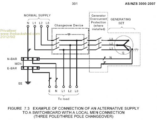

Tinker,
That sort of scenario is really getting into some of the other standards I don't use.
The below pic is the best answer I could give.
In regards to towers I have done a lot with microwave/wireless and the tower was always direct earthed to ground. Then depending on the area lightning arrestors may or may not be used on the electrical side.Edited by Privatteer 2012-09-03
Posted: 07:18am 02 Sep 2012
As per the diagram above that is correct to my understanding as well, it might be said that BOTH earth and neutral from the inverter should share ONE common connection each, and when you factor in using one or more RCD's within the wiring circuits then the neutral will need to be via a common supply.
