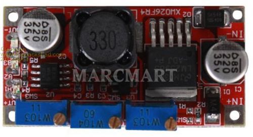

Noticed on E-Bay this device:
5-35V LM2596 DC-DC Stepdown Adjust Power Supply Module f battery LED solar panel
It has 3 adjustments, 2 of them understand, one is V-volts second one is A-amps,
Cannot work out what is 3-rd adjustment for?
Picture copy from E-Bay
George

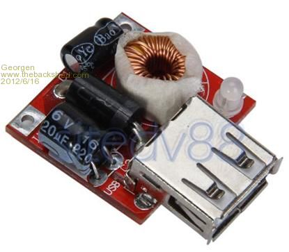

For USB charge I noticed device on E-Bay specifically for USB application
pre-set to 800mA
Picture copied form E-Bay
Is it correct assumption?Edited by Georgen 2012-06-17
