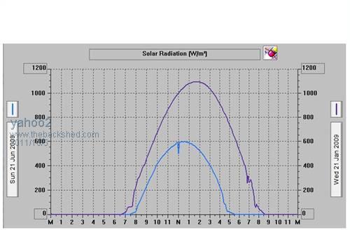

Posted: 04:02pm 04 Oct 2011
Hi,
posting a graph for those of us that love that sort of thing.
Its direct comparison of a summers day and winter Watts/m2.
Its reading about 4% low cos some nasty parrots had gouged the sensor lens.
Here is a few numbers
190 Watt panel
Peak watts Summer 224W
Peak watts winter 116W
