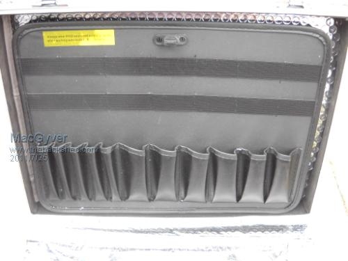

This all started because Harbor Freight put their medium-sized aluminum technical tool box on sale for $19. I couldn't resist; it was my civic duty to buy the silly thing. The first thing I did was rip out the tool-holder part in the lid. I've placed it back in place temporarily so you can see which tool box I bought:
Here's where we're headed:

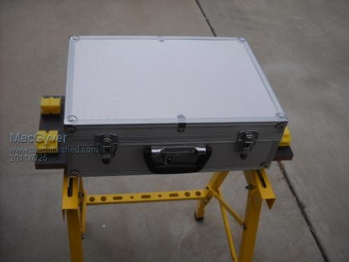

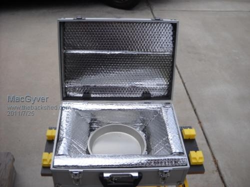

I have it perched on top of my new workmate table I purchased online
for $29; another deal I couldn't resist.

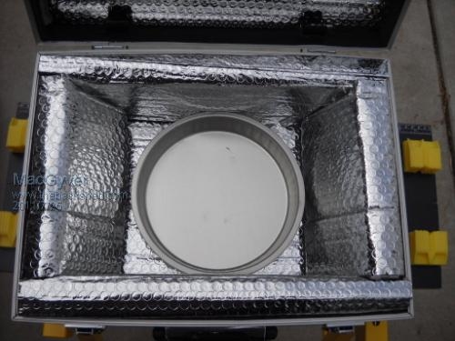

The insides are nothing but chunks of Styrofoam building insulation.
I cut the 1/2" sheets so as to have them "wedge" fit against each other
on the inside of the box all the way around. I overlayed these panels
with pieces of reflective material cut from a dashboard reflector -- $5
at Pep Boys Auto Parts.

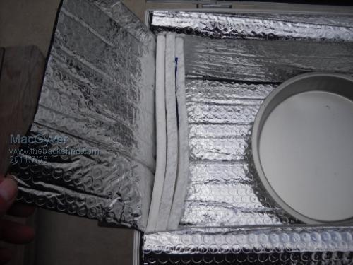

I left the two inside end pieces of reflective material a bit loose. The
idea here was to allow its flexibility to redirect sunlight making it in
that far, towards the center of the cooker where the cake is.

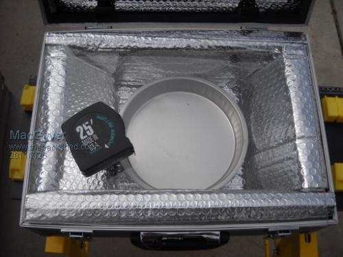

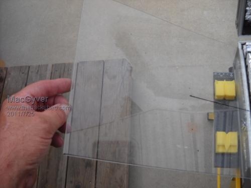

I cut out a piece of Lexan plastic sheet the right size to cover the
inside of the cooker with enough left over on its edges to allow it to
rest on the reflective-covered sides. My tape measure is sitting on
the Lexan sheet since being clear, it otherwise doesn't show out much.
This is another sheet of Lexan, which I've yet to cover with reflective
material (tomorrow). I drew a line on it so you can see it better in the
picture. I'll construct two of these, one for each side and they will be
set at about a 50* angle from vertical so as to redirect sunlight to the
center of the cooker. The whole rig will sit propped up at an angle
aiming right at Mr. Sunshine. By the way, I cut the Lexan so all three
sheets fit inside the lid where formerly tools had been housed.
Here it is all packed up and ready do go on a picnic. As soon as I
cover both side reflector wings and figure out a way to prop them in
place while things cook, I'll do just that. I'll bake a cake and come back
here with an update. On a clear day, this little solar box cooker should
sustain 350*F.

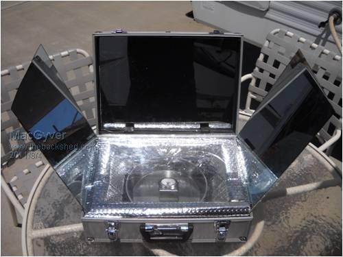

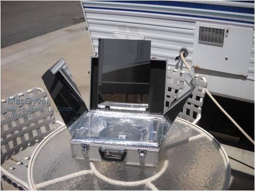

I've made a few changes and will make a few more, but I thought I'd update things a bit to show my progress:
I decided to use real glass mirror instead of the plastic stuff. The
glass gives a more-efficient reflection.

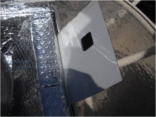

I also changed the size of the side-mirror supports. Seen here, small
Velcro squares were attached to both the back of each side mirror as
well as to the piece of sheet aluminum. I bent each piece to achieve
the reflection targeted on my baking pan inside the cooker. The Velcro
steadies the sheet of glass mirror in the wind. The bottom edge of
the glass is 'wedged' between the case and the insulation; the Velcro
is just for good measure.
Since the angle of the rear mirror is somewhat "fixed" because it's
sitting against the tool case lid, I decided to use it in it's long-vertical-
side position; it gives a better reflection target. One thing to keep in
mind here is WIND can be somewhat problematical and if you're baking
cake on a windy day, you might want to babysit it whilst it cooks.
This little solar box cooker seems to get only to 300*F. The directions
on my cake mix box say 325*F. I guess it will just take a little longer.
There were some comments from the crew about using the reflective plastic inside this thing, but even at a sustained temperature of 300*F I noticed no discoloration, smells or smoke from anything. The Lexan sheet I'm using as an insulation shield got a little droopy in the middle and I may replace it with a sheet of glass, but then again, maybe not.
When I pack this up, all three mirrors fit within the top lid and I pack them securely using the former lid reflector sheet of platic. A double-insulated center would likely allow things to get hotter, but I'm happy with 300*F for now. All I want this for is to bake cake.
One thing else I'm going to construct is a beach-sand-filled base for this whole rig to sit on. The reason is, beach sand is silicon and is about the BEST insulation material on the planet. I noticed when I went to pack things up for storage, the back side of the case (the bottom when it sits on a table top) was pretty roasty-toasty. Apparently, a lot of heat is escaping there and that may be why this little cooker peaked out at 300*F.
Tomorrow, if I'm home between 10 a.m. and 2 p.m. I'll bake a chocolate cake and post the results. I think I've found a way to garner free energy for baking, now if I could only do as well finding some free cake!

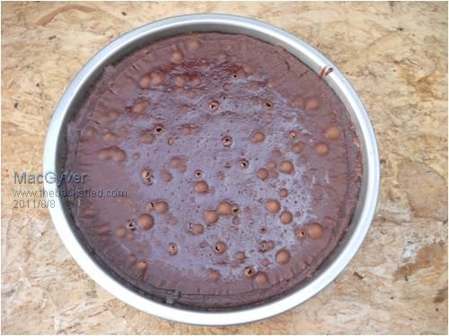

I took Tink's advice and added some metal to the interior of the cooker. I used a piece of tempered aluminum sheet, painted flat black with stove paint. This increased the static (standing alone unloaded) temperature from 325*F to over 350*F so I figured solar brownies were now a shoe-in.
It would seem my affinity for "small" has gotten me into trouble yet again. This little solar box cooker, though it works really, really well, is just not large enough to effectively "bake" stuff. Even inverting my $8 Onida baking pan over another metal baking pan holding the batter didn't help much.

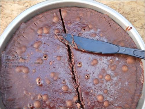

A picture's worth a thousand words, so here are 2,000:
This is the result of 3 hours at 250* (as hot as it would get) when the
box said to bake the brownies at 325*F for a lilttle over half an hour!
Hey, they "look" good.
I ran a plastic knife through them before they cooled (I know that's a
no-no, but I was anxious). Unfortunately, as you can see from the
picture, my solar brownies are a bit too much like me; soft in the middle!
I think I'm going to give up on baking stuff and use this for stews and roasting chicken and the like. I suppose it's in my best interest that it wasn't a huge success, cause lord knows, I really don't need to be munching on cake and brownies 24/7. Still, it's a compact and useful tool that will be used at beach parties to cook hot dogs as well as around here to make "crock pot" stuff now and then.
