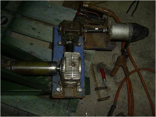

Any way it all worked out in the end after a lot of work by Pete and m self. Pete did a great job on the code and electronics and it all works like a dream. I did use a car diff at the end what a load of fun that was. I had to reduce the electric motor I had and keep it strong enough that the wind did not rip it apart.

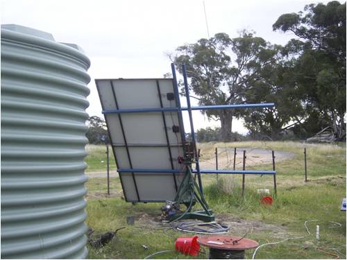

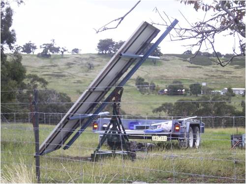

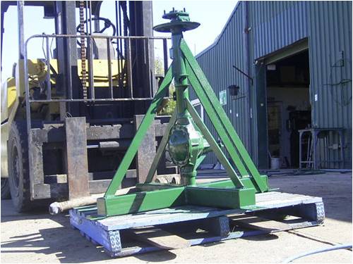

Here are a few photos of the set up..

Excellent job.
Thats a great achievement.
Thanks for posting those pictures.
I have heard mention of using a car diff for a solar tracker, before.
But never seen pictures, and I always wondered exactly how it is done.
Thanks.

Hi All, The car diff was not my first choice as I was doing to re-invent the wheel so to speak untill Pete told me about another system that he helped out a bit with that belonged to a mate of his that worked well.
