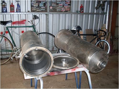

I managed to score these stainless steel tanks out of the scrap skip at work. Which i plan to use as a preheating set up inline between the mains water and my existing hot water servive.

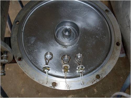

These elements from 12V car kettles i plan to fit as a dump load from my wind mill, which at the moment wont contribute a great deal to heating the water, but as the wind mill developes the out put should improve. I plan to add a home built thermo-siphon solar collector which will do the majority of the heating.

Nice find there mate, I tried out those little heating elements but found them to be a bit fragile as they tend to blow if the voltage climbs to much.
In the end I made a element out of a strip of stainless steel .5 mm thick by 1.5 meters long, it worked good on 12 volts as a dump load suspended in water. I got it from a sheet metal shop as a strip off cut, cost me a six pac.
I wound it on a piece of earthenware pipe as a former with holes drilled to terminate the ends.
All the best
PS:- the reason for my concern with the little elements as a dump load is if it is dumping and one goes out the other two will quickly follow and then you have a runaway mill.

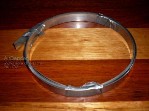

I was given a .5 mm stainless steel strip by a lagging contractor at work, very kind of him, he said he has plenty of it back at his workshop.
I think I have come up with a good idear for the former, but this progect will need to go on the back burner for a while as i have a few other things on the go. But getting the parts together is half the battle.
