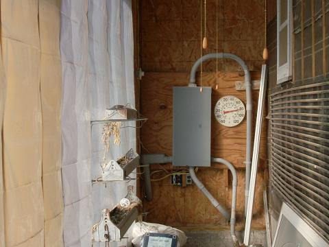

My passive solar area,
It was 9:24 am Feb. 2nd and 4*F outside when I took this picture.
This is my water preheater/radiator, it warms water heading for the hot water heater. The sun also warms the area enough to help heat the house during the winter and because of the roof overhang stays fairly comfortable in the summer mounths.
I have a full foundation under this area and also used 6 inch fiberglass in the sidewalls/ 12 inch in the ceiling. Also I have a poured cement floor to help soak up the warmth.
.....Mac46

VK4AYQ, and everyone,
The project is alittle sore on the eyes to look at, its been up going on the 4th. year now, and I admitt it has been abused as a catch all at times.
During sunny days the furnace won't run at all from 10 am through 3 pm and the house temp. will rise from 65*f to approx.72*f, give or take a few degrees. I have my thermostate set at 65*f during the winter.
By opening the basement window and the bedroom window the air will circulate naturally with no fan at all, all natural passive convection. Air flows from the basemant up to the solar room and from there into the house, as it cools it returns to the basement to start the journey all over again.
This works great provideing the sun is out, but in the real world this does'nt happen everyday, and sometimes for weeks on end. During these times I shut the area off from the house. It has'nt froze the water lines yet, knock on wood.
The collector is made up of 1/2" copper/ thin wall ridgid, and measures 20 feet long, no recirculating pump...its force fead from the deep well pump, and has a one way check valve to prevent backfeed.
The room measures 24 feet long x 6 feet wide, and the floor line is situated 3 feet below the house floor line to aid in the air flow. The room faces due south.
.....Mac46
