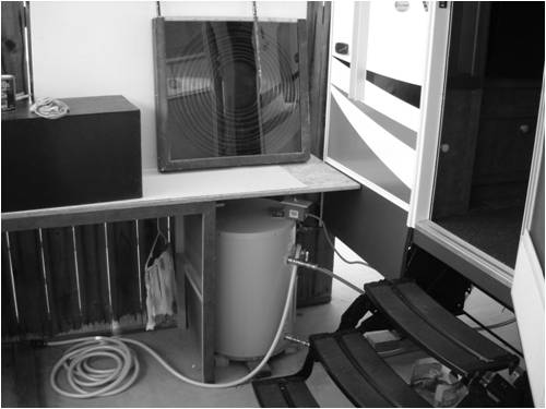

Anyway, I threw together a small solar water heater today:

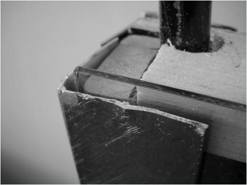

It's approximately 27 inches square. The clear window is Lexan and the frame was formerly a frame to something else (I found the metal at the junk yard heap). I cut the original frame in half, sandwiched the Lexan between the aluminum frame and some wood (so as not to crack the silly stuff!), painted things black and screwed it all together.
Here, you can see how stuff was sandwiched together using screws and wood:
Here's a tight shot of everything cramed together:
The coil is a nearly-50-foot roll of 1/2" soft copper painted black to absorb the sun's heat. I wound the pipe in what's called a "flemish". It's like a snail's shell, which starts at the center and slowly increases in diameter as loops of pipe are added. The finished product is a "spiral".
The water will be pumped through it from one end of the pipe to the other (not sure which way will be in and which will be out -- but that doesn't matter). I'll draw the cooler water off the bottom of my 20-gallon storage tank and return it to the top using "T" fittings on both the cold and hot lines at the side of the heater. All lines exposed to air will be insulated with thermo-cell pipe insulation and painted to resist UV decay.
Here's a shot of the finished product perched atop my new 20-gallon electric heater:
Tomorrow, I'll try to get the pump and pipes fitted and mount the collector on my RV's roof. Maybe I'll have a solar shower tomorrow night, eh?

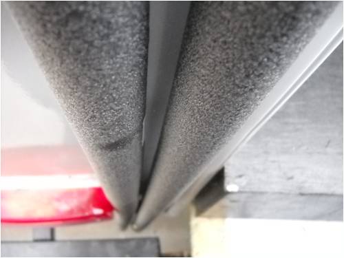

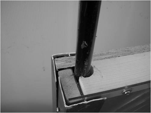

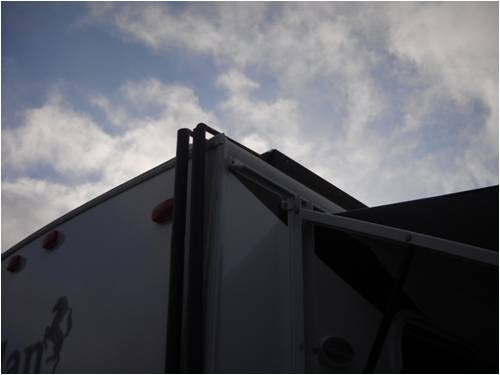

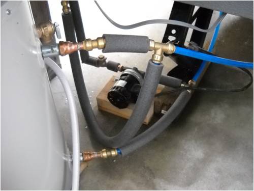

It's flying! I tied in the panel, the tank and the little pump today, filled it, purged the air and am now getting solar-heated water rolling in a loop between my storage tank and the little flat-plate panel on my roof.
Here's a shot of it mounted on the roof. The in and out pipes are each insulated. If you don't insulate the pipes, which are exposed to the air, it doesn't work very well, if at all; gotta insulate!
This next shot is from the roof looking down the inlet and oulet pipes. The pipes are anchored to the side of my RV with clamps over the thermo-cell insulation.
This next shot shows all the plumbing connections, with the little pump in the background. The pump is mounted on a wood base to keep it off the cement. The pigtail (electric cord) plugs into a timer that is mounted in a plug just under the RV's skirt (not showing in this shot). The pump runs from 10 a.m. to 5 p.m. daily in the summer.

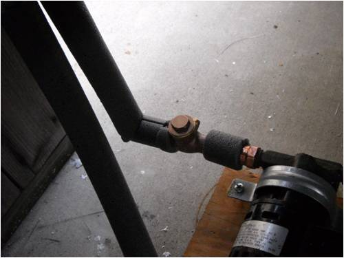

Here's a tight shot of the little swing-check valve I put in the output side of the pumping system. This will prevent back-flowing of water. I also put in what's called a solar loop (see photo above--large half-circle insulated pipe) in the outlet pipe leading to the upper (hot) outlet on the receiver. Heated water doesn't like traveling against gravity (down) and the "loop" facilitates that and keeps the hot water in the tank.
Without the loop, if the check valve sticks for some reason in the open position, the fact that the water in the tank is heated will cause it to rise by thermo-siphon all night, since the heated water is below the collector on the roof. If this happens, the collector becomes a "radiator" or heat exchanger and all your precious solar heat radiates to the night sky and in the morning you have a cold shower!
That's about it. I'll let it perculate for a week or so and get back to everyone as to how much and how hot the water gets courtesy of our nearest star.

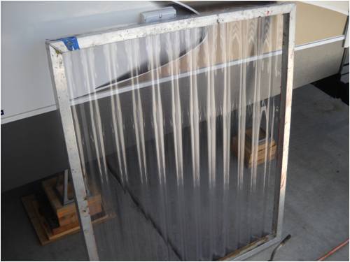

MacGyver
Joined: 12/05/2009
Posts: 1330
Posted: 02:28am 22 May 2011
Project Update
I was telling someone just last week how I was great at starting new projects, but not so great at finishing old ones. I'm happy to say, I've finished a project: the second-generation solar water heater for my land yacht.
This current model is nearly 4 times the surface area of my first one. Although the first one works, it doesn't have the capacity to do what I want it to do, namely heat 20 gallons of water to about 120*F on a daily basis, courtesy of Mr. Sunshine.

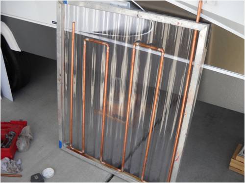

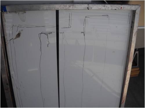

Here's what I did;
I started with a 1 1/2" square aluminum tubing frame formerly used
as a screen-printing frame. The corners are welded and each run is
concave on one side to discourage warping. I laid in two sheets of
about 12 gauge aluminum (couldn't scrounge one piece large enough)
then drew lines representing the pipe's flow through the unit.
Next, I purchased a Lexan garden-shed roof panel for around $9 at
the Home Depot. This will be used for the unit's window to let in light.

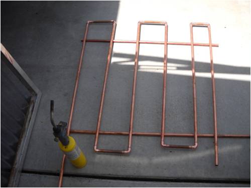

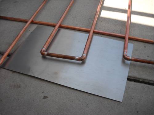

Here I've laid out the run of copper tubing and "benched" it on top of
a few other pieces of pipe to allow me to "wet-wipe" my solder joints.

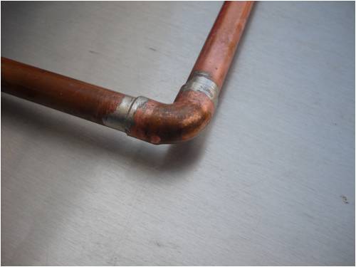

This shot shows one of those typical joints. Note how the solder is run
all around the fitting. That's important to insure a good seal.
I placed a spare piece of sheet metal below my solder joints to insure
I didn't drip excess solder and flux onto my concrete patio.

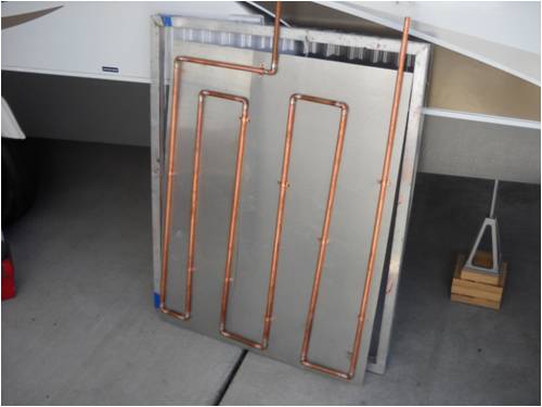

Here's a quick look-see showing how the copper tubing will fit inside
the unit sandwiched between the sheet-aluminum heat sink and the
clear cover.
Here's that same shot with the heat sink slipped beneath the run of
copper tubing.

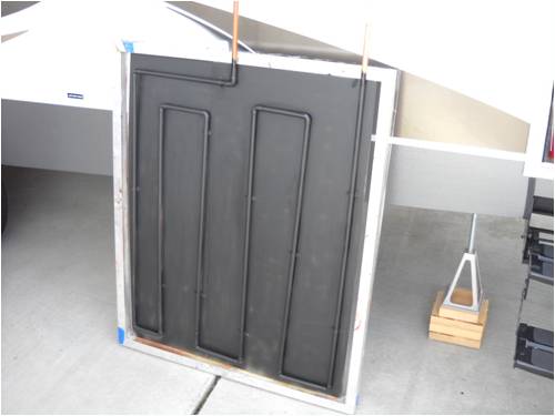

Here it is with a coat of flat-black paint. Anybody see anything wierd
about the attachment to the heat sink? I got it backwards and had to
take it apart and put it back together on the other side; kinda like
building two left wings when you're making a plane from a set of plans!

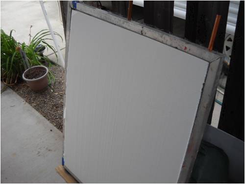

This shot shows the 1/2" sheet of builder's foam insulation. The heat
sink will sit perched on top of this in hopes it will help concentrate
the heat and prevent losses.

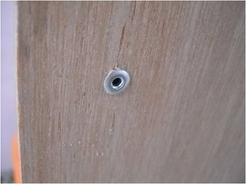

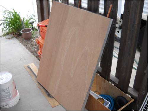

Since this whole contraption will be strapped in place on top of my
rubber-roofed land yacht, I didn't want anything to protrude, which
might catch and tear the roofing material, so I pop-riveted a sheat of
luan to the back side of everything. The luan will be protected from
the elements for the most part because it is exposed only at the edges
and my roof is crowned, so no water can stay.

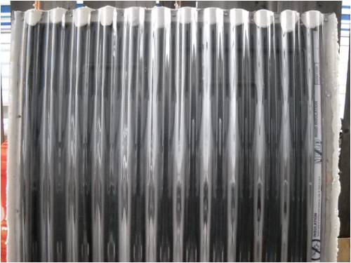

Here's the entire panel with the back cover on, leaning against my fence.

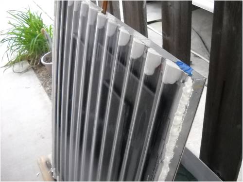

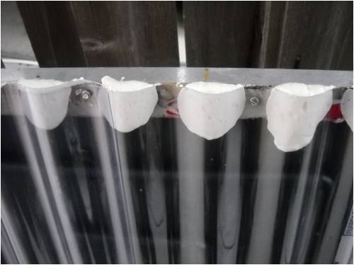

In order to keep air circulation to a minimum, I filled all the wavy open
ends of the Lexan plastic lens using expanding foam. This stuff is
tricky at best. My last fill job beats the heck out of my first, but nobody
except the birds will be seeing it, so it won't matter much. I'll trim the
overages with a cerrated blade after stuff cures over night.
This shows the foam-filled edges from another angle.
And here's the done deal. I'll let the foam cure over night, then trim
off all the protruding edges. All that's left to do is install it on my
land yacht's roof and hook up the plumbing.
I'll use it for a week or two and then share some data on how it works. My hope is that with nearly 4 times the surface area of the first attempt, this will make hotter water. I'm also going to change up the direction I pull and push water through the receiver. Now, I pull the cold off the bottom (with a pump) and push the solar-heated water in at the top. If in fact the water from this new panel is very much hotter than the first one, I'm going to reverse the flow direction and put the heated water in at the bottom. This will allow it to "thermo-siphon" or migrate by itself up through the cooler water in the tank and maybe heat things more uniformly; maybe not. I'll let everyone know the results if I do reverse the flow.

Mac, now that your collector is 4 times as big why not make that 5 times by connecting Mk. I in series?
What struck me odd with your Mk. II design is your use of soldered elbow joints. Surely, as a plumber, you would have the equipment to bend the copper pipe into a nice U and do away with all that soldering? Too much time to mess about perhaps?
MacGyver
Joined: 12/05/2009
Posts: 1330
Posted: 07:39pm 22 May 2011
Tink
Two excellent ideas.
I don't think I have enough room to put both atop the coach. I kinda saw that coming, so I painted the Mk. I with latex paint in case I needed to recycle it. The latex will merely peel off and I can use the 50 feet of soft copper for something else, as I merely had it sitting about any way.
As for bending pipe in tight "U" shapes, it is possible, but it's a pain in the drain. What you have to do is fill the pipe with very fine sand, like beach sand. This prevents the pipe from kinking when you crank it about a tight radius. The sand is solid enough to support the inside of the pipe as well as not compress while also allowing movement at the same time. I've never tried it with half inch, but pipe size shouldn't matter. I once made a flash boiler this way using 3/8" soft copper and wound it into 1 1/2" coils, which were nested inside a boiler housing.
I stayed up all night watching old movies on the boob tube, so I haven't gotten the Mk. II up on the roof yet. I'll get to it sooner or later. Thanks for the input.
Edit
It's later in the day and the new larger panel is now mounted on my roof. I bled the trapped air, switched on the pump and now it's just a matter of sunlight exposure. The entire morning was heavily overcast, so I didn't miss much sunshine by getting a late start. The panel's been up about 3 hours now and the water in the loop is 'warm'. I'll log the tempertures for a week of full-day exposures and post the results here.
. . . . . MacEdited by MacGyver 2011-05-24
Copeville, Texas
Posted: 02:10pm 23 May 2011
  MacGyver said   Tink
. . . . . Mac
Mac, now you *really* surprise me, I had no idea the plumbers in good old USA still use stone age pipe bending methods
Ever heard of a thing called a pipe bender? There are several types, the fancy ones (I have one of them as well) use a half circle die and a matching straight section to wrap the pipe around a fixed diameter radius, around 3". This one does bends up to 180 degrees.
Even fancier is the three roller type that can roll bends of many different radius's and even full circles (I have a home made one of these to bend the ss tubes to make the rails etc. for my sailboat).
But the simplest for soft copper pipe is just a spring section (comes in a kit for various pipe sizes) that is inserted into the pipe at the right place to prevent the wall collapsing - just like your stone age sand does
The spring is then pulled out and set to bend the next U...
Consider yourself dragged into the 21st century now
