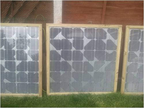

Hi im new to this as well i have built my panels 36 x 6x6 3.75 w cells the put out about 20 v 14v when connected to the batteries.
Today 4 of them in mild sun pushing 6 amps into 12 x 2 v bank of 2 and 6 x 6 v bank of 3 still finding out how well they work you have to put 30% than you use
