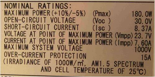

going by the panels specs the mpp 23.7v (see below)
Q: 16 panels in series would be safe (16 X 23.7Volt = 379.20 mpp volts)
Q: max voltage would be max open voltage of 30v x 16panels= 480volts

OK limiting factor is the VOC
aim for panel voltage max VOC x 1.2 to be under the 500V
EG the panels you have with VOC of 30 V
15 would be 15 x 30 X 1.2 =540V BANG!
thus 13 would be max in a single string.
Max input current at 19A is next
theoretically it controls this itself if you run more by driving the panel voltage higher to limit input current.
your panels at 7.6A normally would run max 2 strings of 13 panels
=26 x 180W = 4680W. for realistic output multiply by 0.8

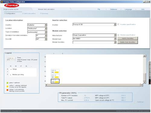

ok i actually have put them last week, 15 in series.....
the highest voltage from the panels on a nice 20 degree cloud "edge" midday effect day was 394v and the peak watts was 2792.
you say a VOC factor of 1.2 (30 * 15 * 1.2= 540v =bang!)
i used the fronius configuration tool imputing all the bits it wanted (including my
actual sharp models) and it came back at 15 panels. as the perfect match to the IG30
Also noted a spec sheet for the panels said the max VOC of 30.2v was at 1 degree
how much more volts do these panels make at say -5 degrees (cold Melbourne morning)

Voc is normally experssed at 25degrees so if it is 30V at 1 degree then 15x30 is 450V and should be OK.
I hope all your gear is appropriately rated - normal TPS is only rated at 450V once secondary insulation is stripped back and the Aust std say it must be 1.2x higher rated. SDI (Single double insulated) cable is often used as its rating is typically 1000V.
Same for your isolator should be rated to 1.2x VOC which means std 500V isolators are not legal.
CMS has 800V breakers cheap
http://www.carbonmanagement.com.au/shop/shopdisplayproducts. asp?id=5&cat=Accessories
and if it were me -i'd do it! DC breakers have been known to fail when operated incorrectly.
As for the -5 mornings it wont matter as the it will be more like 30W/m2 vs the 1000W/m2 that the figure is derived from.
Only issue normally is shutdown on a 10 degree day during grid outage, and edge effect peak to push it up and pop.
Given their own design tool says its OK, then I guess its OK
