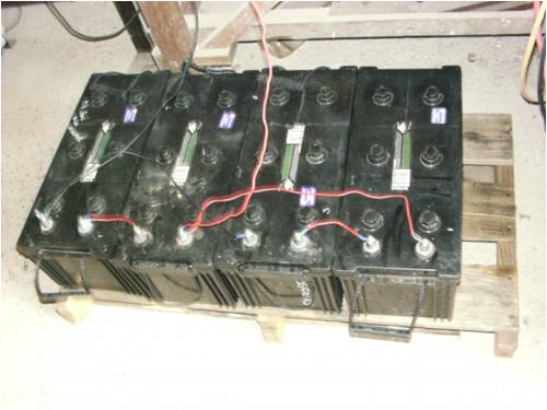

This was a set of 12 volt batteries that belong to a friend they where dead flat when I went to work on them and had been flat for nearly a year, now they are at around 80% capacity and sitting on the side of my battery bank.
It is the little alloy box on top of the battery
Batteries tied to main batteries

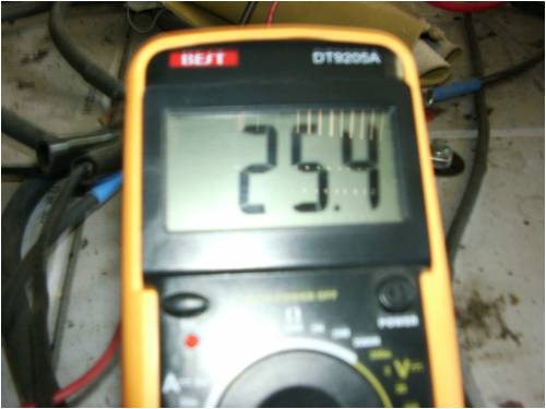

This is the voltage at rest after a few weeks of desulphation

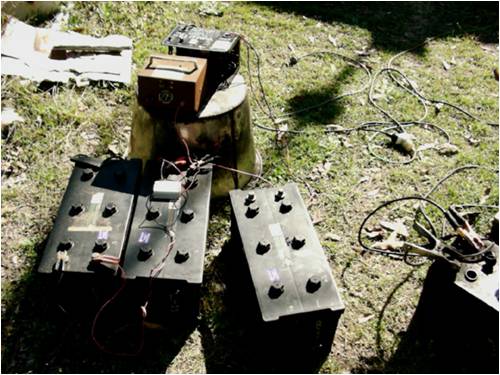

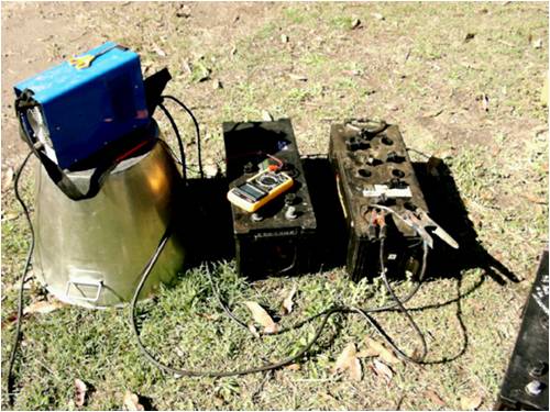

I used my little welder to get them conducting initially as they would take any charge at all on a normal charger.

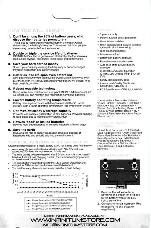

Posted: 07:35am 08 Mar 2011
Hi ian
This is the instruction sheet from the pack the desulphator comes in.

I'm curious as to the welder technique Bob.
looks dangerous to say the least
Posted: 04:10am 29 Mar 2011
Hi Karl
There isn't a problem with this particular welder as it is an inverter welder with synchronous rectification so there isn't any back feed its output is 26 volts slightly spiky DC so it is good for charging it is only a trickle charger on 24 volts but is good for stirring the phosphate out of a 12 volt battery it has revived many batteries.
I always do it outside as there is a risk of blowing a cell if it decides to overheat.
Most people die in bed but we still go their on a regular basis.
You don't put it on an leave it, it must be monitored and the cell activity must be observed a few minutes at a time is generally enough to get the battery conducting again once it is conducting back to the normal charger on boost setting and the desulphator, it can take a couple of weeks if the battery is badly sulphated to see if its worthwhile.
